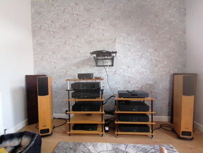

Its finally here, now i can see what the fuss was about.
Any apheta 2 users got loading recommends. Currently 100 ohm and 1nf

Well its sounding sublime at the moment. Not even warm

Dont actually feel like changing anything. Even swmbo said wow
