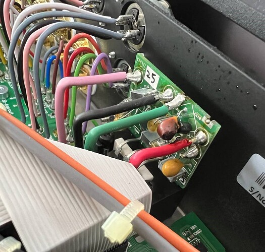

Hello guys, quick update. I have opened the unit myself and took a look.
It seems the DR module for the pre amplifier is busted. The capacitor exploded. Can anyone shine some light on why this is?
Things can sometimes fail inexplicably. It’s why there’s a warranty. Carefully put back the cover and get in touch with your dealer so they can arrange for a repair.
