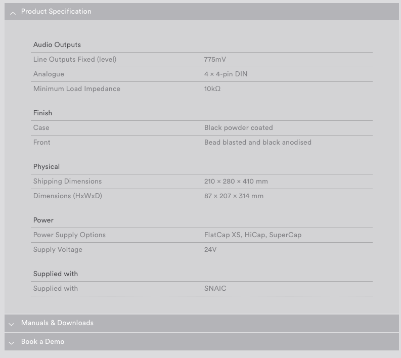

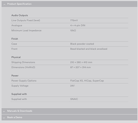

The SNAXO 242 product page says a SNAIC is included but is not specific:

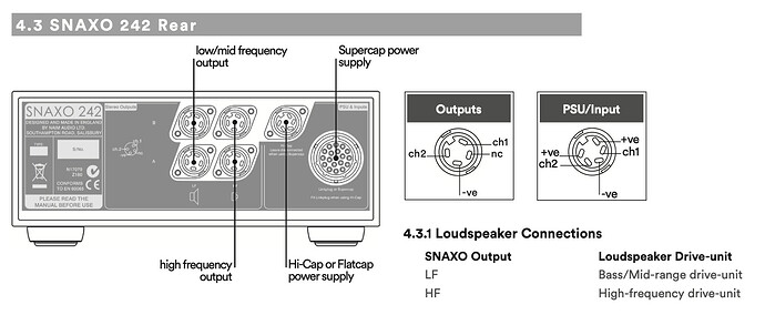

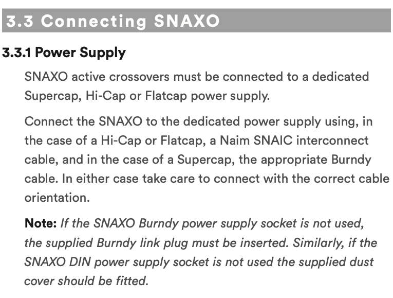

Another oddity from the SNAXO manual (PDF anyway, I’ve not opened the supplied packet):
There is a Burndy link plug which is in use, but no dust cover for the SNAXO DIN power supply socket, should there be one or is this just a typo? If it’s just a dust cover it probably doesn’t matter but if there ought to be a DIN blanking/link plug it’s missing and might cause issues if I wanted to try the Supercap DR with the SNAXO 242.
I think it will be a SNAIC4 to link your pre-amp’s PS to the PS driving the SNAXO.
No point in including a SNAIC5 as this may not be needed (you may be using a Supercap), however, a SNAIC4 to link the PSes together will always be required, hence included (where something is always required, Naim invariably include it).
p.s. I haven’t seen the old dust covers being used for quite a while. They were always confusing newbies to Naim thinking they were the link plugs and vice versa, so maybe Naim decided to drop them?

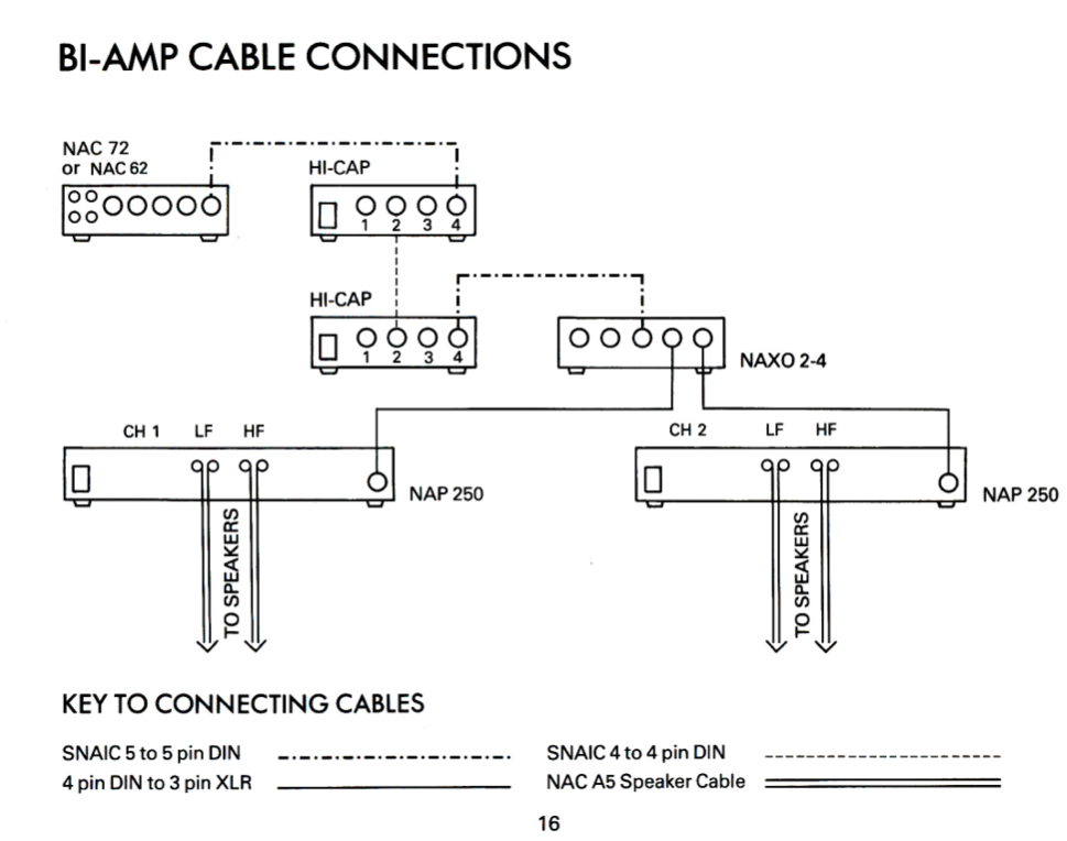

I think the reason this question baffled me is that the SNAXO 242/363 manual only shows the connections from the power supplies to the SNAXOs and NAPs.
The ancient manual I had with my 72 I think showed upstream connections to the NAC 72 as well when used in ‘bi-amped’ mode.
***!!! WARNING - completely wrong for SNAXO 242 where the NAPs are now LF or HF not L/R!!! ***
Maybe the current ‘connections’ guide has this too.
Also fair to say that the current SNAXO manual does not indicate which accessories/interconnects are included and specifically in relation to the SNAIC does not indicate where it lies in the chain - probably not a concern if things are dealer installed.

In a Naim active system the only signals that are needed to connect the Hicap (preamp) to the Hicap (NAXO/SNAXO) are:
Left signal
Right signal
Signal return.
The connectors at both ends are DIN4. The “standard” interconnect they manufacture a four wire SNAIC4 where the fourth wire “can/may” be utilised in certain configurations to carry secondary power from “a power amp” to “a preamp”. This is clearly not the case in this configuration.
Unfortunately this means that there is a length of wire in the SNAIC4 which in this particular ‘active” configuration is AFAIK unconnected, “floating”, and therefore will act as an aerial.
