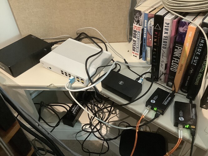

Hi folks, having working my way through switch confusion I have arrived at the below.
Sky Router via chord c stream into Cisco 2960
Cisco 2960 / via chord c stream into EE8 switch
Adot from EE8 into Innuos sever (melco ethernet)
Sever into NDS (melco ethernet)
Is this the optimum set up (not sure I have the ADOT in the right place?
Thanks and and guidance would be appreciated.
You seem to have a whole bunch of network hardware and cables located very close to your HiFi. Put it as far away as possible, preferably in a different room and on a different mains circuit if you can.
That’s the idea with the EE8 and ADOT, they are close to the streamer.
DG…
Bit of rats nest I know …. It is on a different circuit to HiFi though but agree it does need a tidy up!
I can probably get most if it in the cabinet just behind the main system
It looks like you have both ADOT units running off the same PSU via a Y cable which somewhat defeats the purpose. You isolate them via fibre and then connect them electrically together again.

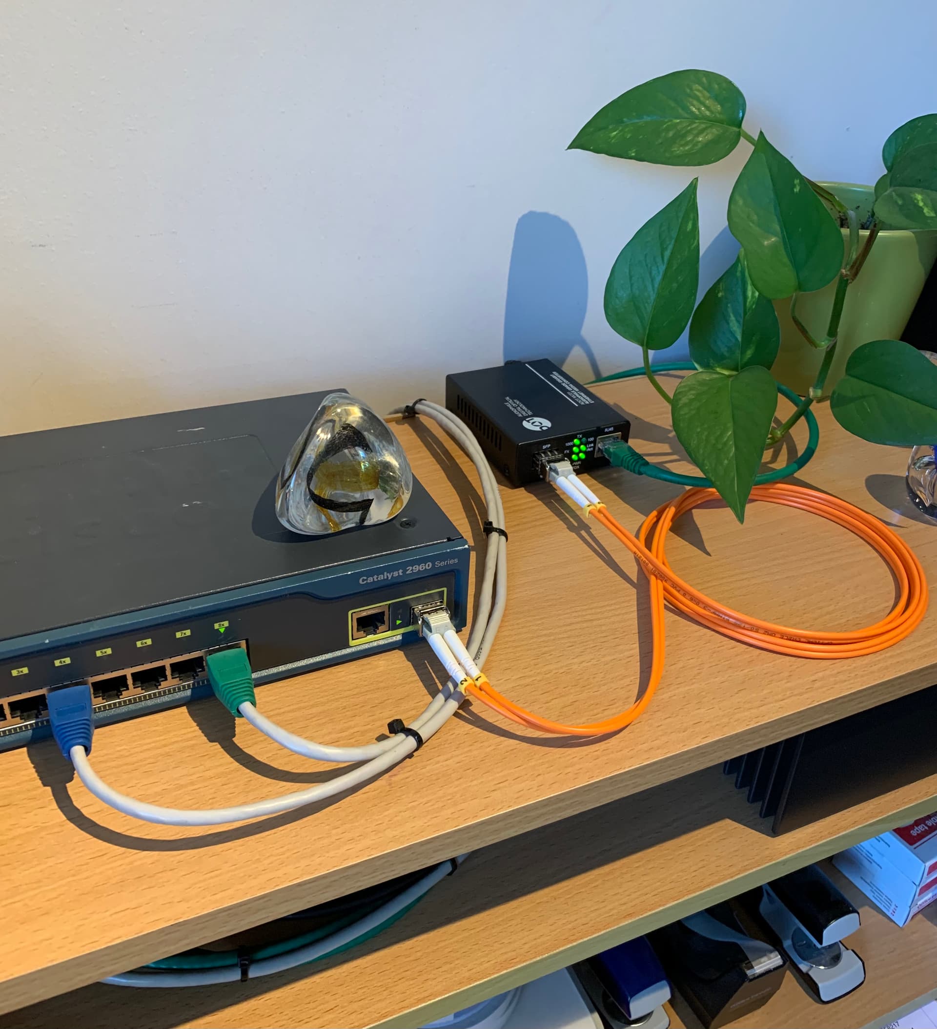

I’d be tempted to get an SFP module for the Cisco and then you only need one ADOT converter.
and just connect this the ADOT converter.
Run the output of this ADOT into your Innuos server.
Thanks James, I don’t fully understand. The two adot boxes are powered by the Plixir - is this not optimum and if not what is needed to be optimum - apologies for being a bit of a thicky but my brain goes to mush on all things technical….
Gary
It does work in this configuration……as i heard in a demo. What James is referring to it the “y” connection connects the in and out with the potential same noise source.
My home demo with this “y” connection ended in a no buy……probably unrelated.
James is right, but it is extremely hard to have them electrically decoupled in the first place. Just putting their switch mode power supplies in an outlet have them electrically coupled. Unless you have one Adot in another house and run a long glasfiber cable in between (which you can).
In practical terms, having them both fed by an Elixir gives a much cleaner signal. The benefit of having a common ground plane by hooking them both up to the same PS doesn’t apply here, since the ADOTs are connected by glass fiber and not an electrical ethernet cable.
Having said all this. The Electrical Elephant in the room is the quality of the internals of the Adot. Nothing I’ve read so far convinces me they are re-engineerd boxes, but rather common glasfiber - to - ethernet converters with a new logo slapped on. These are electrically noisy! So, you go to all the trouble to put glasfiber in between to isolate the streamer, to inject electrical noise again by the last fiber converter in front of the streamer. Having that one hooked up to the Plixir is probably wise.
