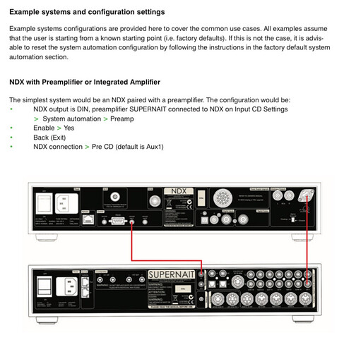

Your ndx2 is only connected to one input on the supernait (I assume you are using din-din), so you can’t switch input on the supernait and still listen to the ndx2.
May be obvious but worth noting that the NDX2 input button on its remote allow you to switch. So for example my CD transport is connected to my ND555 so I need to change inputs on it to use a CD using its remote. System automation will switch the input of my 552 to the correct channel if I’d been playing vinyl on a different input.
That’s what’s there now! It’s got the convenience of pressing the button on the front of the amp, at the expense of another box, and not using the NDX2’s way superior DAC elements.
Well I think system automation only seems to work from source to amp. I’d never even thought to try, since we never touch the amps. They are “way over there…” and SWMBO has been trained in expert use of the remote
If I use NDX2 to change input to Vinyl the 252 switches to Aux2.
Pressing CD on 252 does NOT influence the NDX2, it still says “Vinyl” on display, not TV.
I think to do what you want via front panel input buttons you would need one physical device per input connected to SN3, but I could be wrong.
