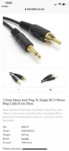

Thanks for the advice guys, but the only thing in the back of my NAC202 is an RC5 in. Do I need to get a 3.5mm to RCA for this to work?
Yes, you need a mono 3.5mm to RCA lead. The last one I bought cost less than £1 from an online retailer called Kenable, available in various lengths:
