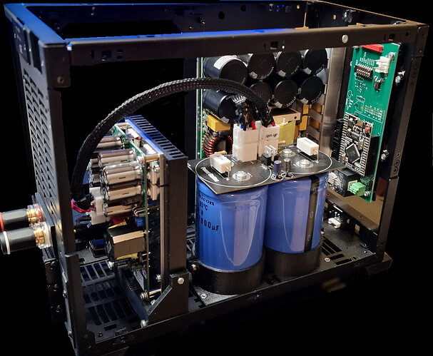

This text is translated with chat gpt from the previous owner.
“‘Nice to have’ and ‘need to have’ lists were sent to Armand… by request. Not unexpectedly, such ‘nice to have’ lists are considerably longer than the ‘need to have’ ones, so we crossed out quite a few items… they can be revisited later if needed.
Anyway – long story short, other variants than the ones shown were discussed and rejected, as alternative B turned out to be fully feasible! The solution is based on the Hypex Ncore NC1200 module with an SMPS3KA400 PSU (63V rail voltage), combined with various custom convenience features, extra safety measures, soft-start (1.6 Ohm is a bit of a nightmare to fire up…), and so on. Modules and accessories were purchased.
Some years ago, I was involved in developing a temperature controller for high-power electrical applications, and one thing I discovered quite early was why the competitors hadn’t managed to create a similar product… They struggled with heat buildup, dust burning, and unstable operation. The reason was horizontal mounting and a desire to make the enclosure as small as possible.
We did the opposite – we mounted the electronics vertically, with the cooling fins on top and the temperature sensor at the very bottom of the enclosure. The result? A deviation of only 0.2 degrees at the thermistor (temperature sensor) between 0 and 100% load. The enclosure worked like a chimney, drawing cool air in from the bottom, past the thermistor, then over the cooling fins and out the top – across a small “spoiler” that directed the airflow away from the wall, effectively eliminating dust burning as an issue. A very useful experience indeed.
Transferring this principle to the amplifiers here, I ended up choosing a so-called midi PC case, since these have exactly the properties I mentioned: extremely good airflow from the bottom straight through the case, plenty of space for the modules, and full vertical mounting. Measurements taken during testing confirmed its effectiveness.
Regardless of what people say or believe, Class D amplifiers with their accompanying SMPS units do generate heat, and there’s no point in cramming the components into a tight, closed enclosure. That can easily cause unstable operating conditions – not to mention it makes assembly, measurement, and troubleshooting a hassle.
In addition, extra heatsinks were installed on the modules – big thanks to audiom who had a few lying around – they fit perfectly!
Power module on the left, with extra heatsink.
MOSFET-controlled capacitors for soft start…
PSU mounted vertically at the back!
All mounts for modules, soft-start components, etc. are 3D-printed.
