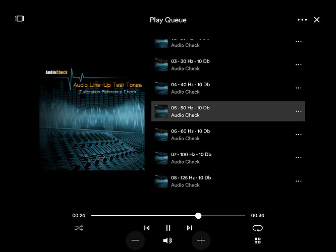

Found this on Qobuz, interestingly I can hardly hear 40hz although speakers rated to 32hz, at the top end I can’t hear much above 12k, wonder is that because of Qobuz, my streamer / amp or just my ears! It’s interesting to play 50hz and walk around your room.
As a test you could try and play the following through your streamer as a confirmation

That’s more audible, much more so behind the speakers (rear ported)
I’ve tried the same disk… it’s our ears…
(Spendor quote 32Hz without specified limits, so it’s probably -6dB down by then anyway… )

Stereophile found 10dB down - however more or less level to 40.
However, the room can easily destroy bass at any frequency/frequencies: in my own room there was no bass at all when I first set up on moving in and set up as as planned: it took a complete rearrangement of the room, assisted by using REW, to get the bass back - and that is with speakers that dig a lot deeper than those Spendors.
The A7s in my system go down to 30Hz with plenty of volume on the same test as you’ve used. Room or system I wonder? Maybe speaker placement?
Yes room possibly, my room is a bit weird
Walk around your room when playing the 40Hz. Your seating position might be in a null due to room modes.

The 12k will be your ears… the 40hz is probably room null…
