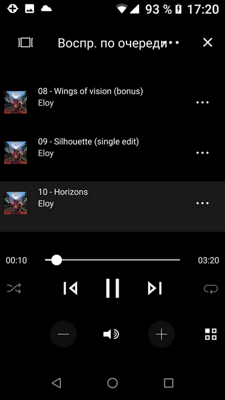

Soon after the purchase, NDX2 began to notice that the Android application on the smartphone does not always work correctly: When playing the entire album, the first track becomes the last in the list.
Going to the next track is not possible.
If you do not touch anything, the first track will play to the end and stop. If you click on any previous track in the application, NDX2 freezes (the device functions, but the sound becomes completely quiet) and is restored only after a reboot.

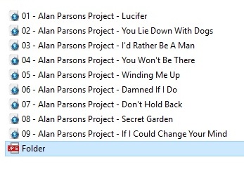

The track names are preceded by numbers as you can see in your screenshots. These numbers derermine the order in which the tracks are listed. For example, in your first screenshot, the track Lucifer is named 09-01-… If it was just labelled 01… it would play first, so it looks like your album titles may have been messed up.

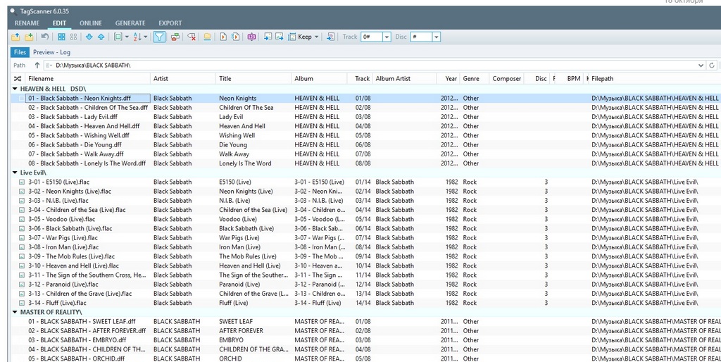

I also tried the tagscanner program to number tracks, delete metadata and number tracks.

A screenshot of the Tag data is what is needed here with sight of the track number field.

In the Live Evil album, you have track titles where the album title should be, which will cause problems.
