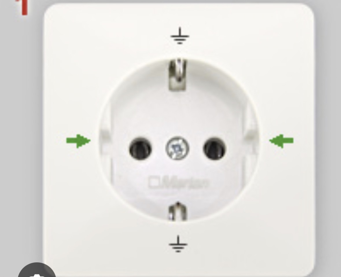

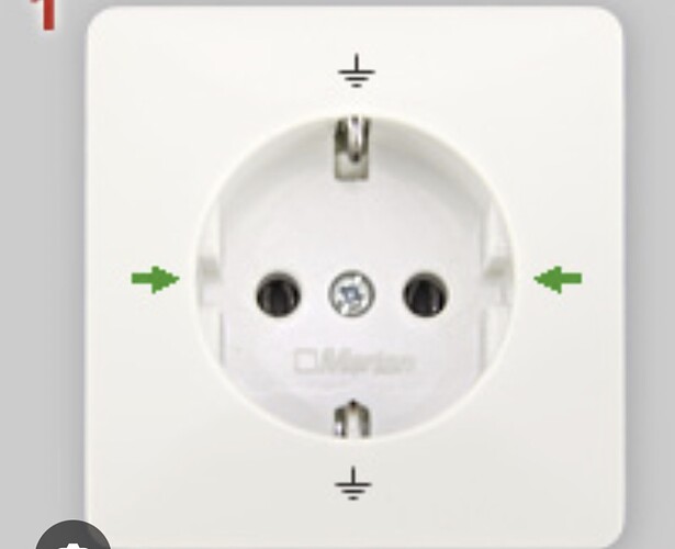

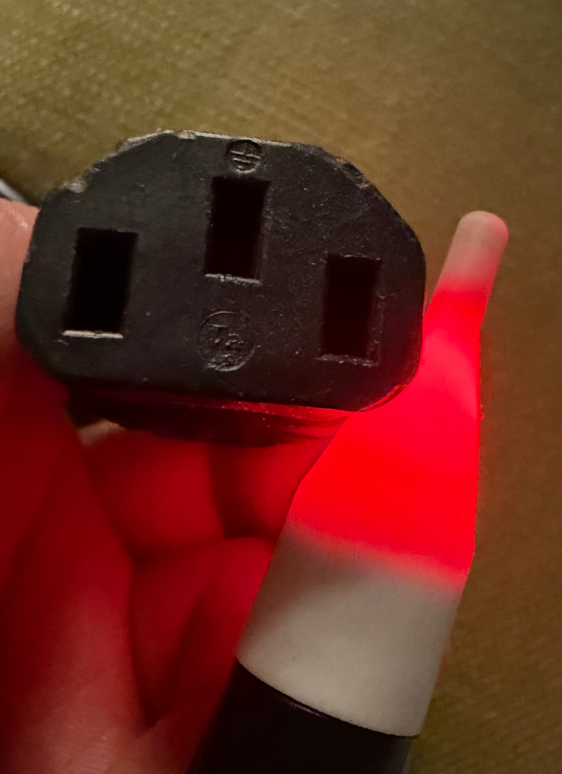

Having the the Naim system connected with the right phase from the outlet is also very important,
not discussed much because they don’t have that problem in the UK as they can’t turn the power connectors the wrong way ( smart with 3 Pin connectors)
The phase must be on this side,when connecting to Naim equipment.
