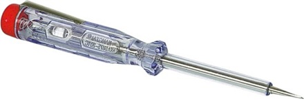

You only nead a phasepen (spanningzoeker, for us Dutchies), like this:
(available at every DIY store or probably Action for only a few euro’s)

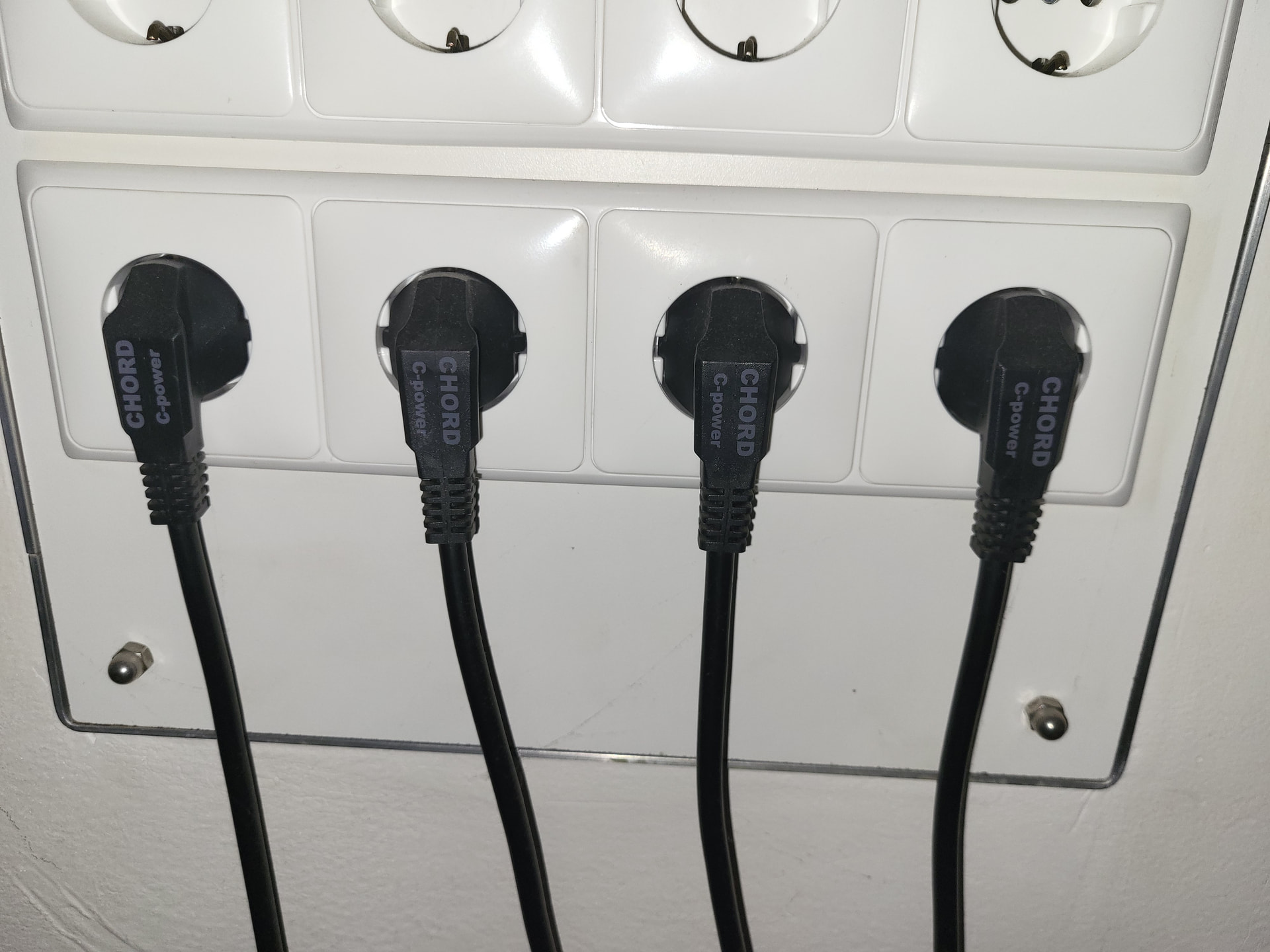

If the wall socket is connected correctly, the live wire is on the right-hand side. Fitters do not always follow this rule. If you have an angled plug, the cable will point downwards when the wall socket is connected correctly.

Thanks for the explanation, Gerben. The plug on my mainsblock cable is not angled btw.
I plugged in both the Nait 50 and my Rega IO, both now with the powercord in phase!
