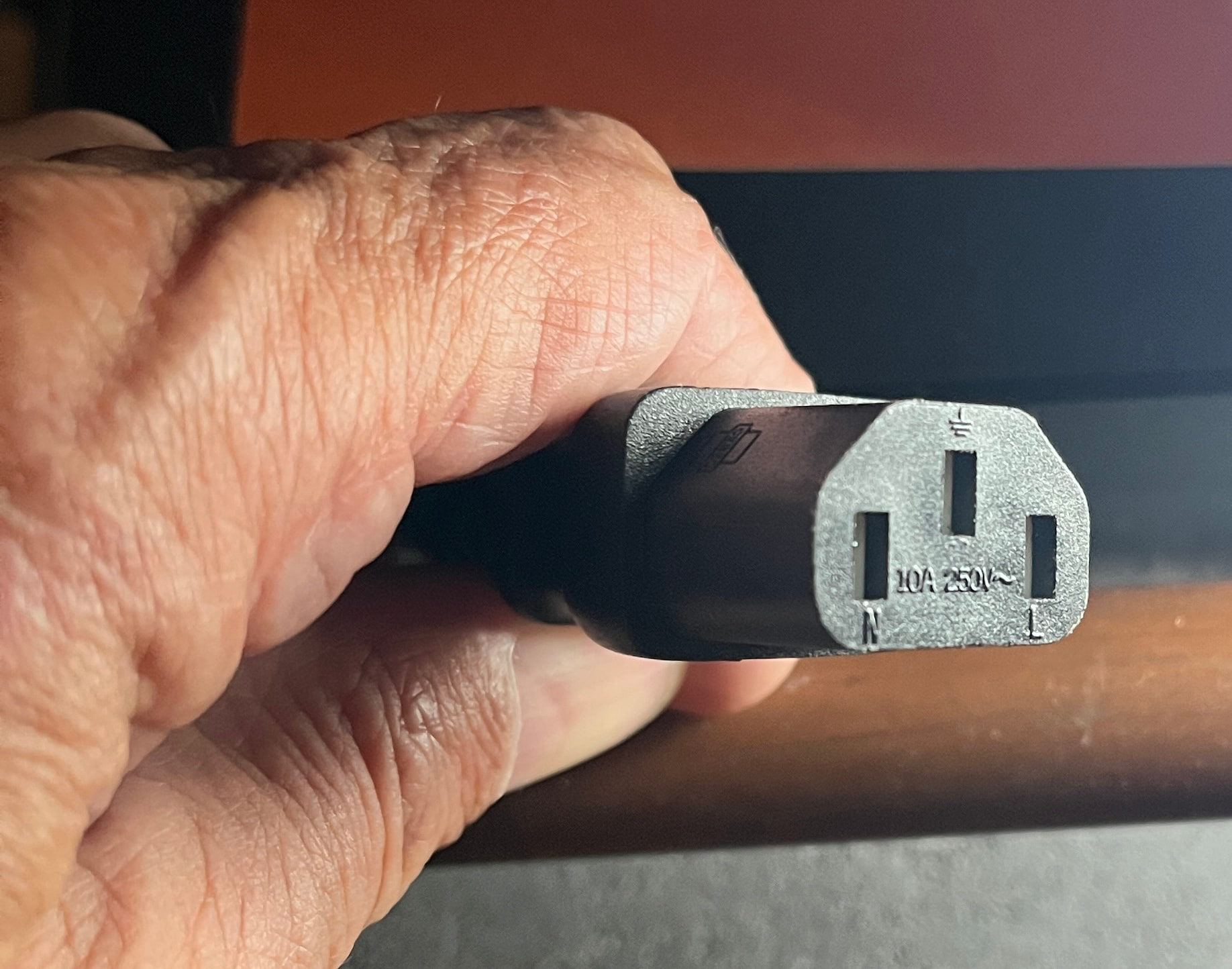

@Igel I can’t thank you enough, for mentioning that the phase side on the end of a powercord should be on the right side.:+1: :slight_smile: I feel kinda stupid thinking it was the other way round all these years, and therefor having several amps connected wrong. It may be bollocks for the (probably many) non-beleivers, and tbh I can’t blame ‘em, but I just spent about an hour listening to some favorite albums/songs and my system has never sounded this good. :slight_smile:

That’s correct,power cords can also be wired wrong even in the UK ,I agree always check the phase :+1:

The Live, Neutral and Earth are labelled on the connector of the power cord Naim supply in the Netherlands with the NC equipment. It confirms that the right connection is Live,
in contradiction to what I was told some years ago.

It can still be wrong in the wall socket so L and N is swapped. Thats why you always should verify with a phase pen.
Thanks for the information. Just ordered a phase pen, so I can try this out :slight_smile:
Please do not rely on just a phase pen to swap any behind the socket wiring, particularly on older installations, and never on a 3 phase installation, as is still common in rural areas in Europe. Always get an electrician to check the complete installation. Always.
Why swap N and L in the socket? You just turn the schuko 180 degrees and make sure L is lit up with a phase pen on the IEC that goes into the electronics.

The leads can often be connected either way round inside at the wall plug end so you need to check with an induction pen and ensure that L and N actually do correspond to the same and correct pins at the IEC end.
