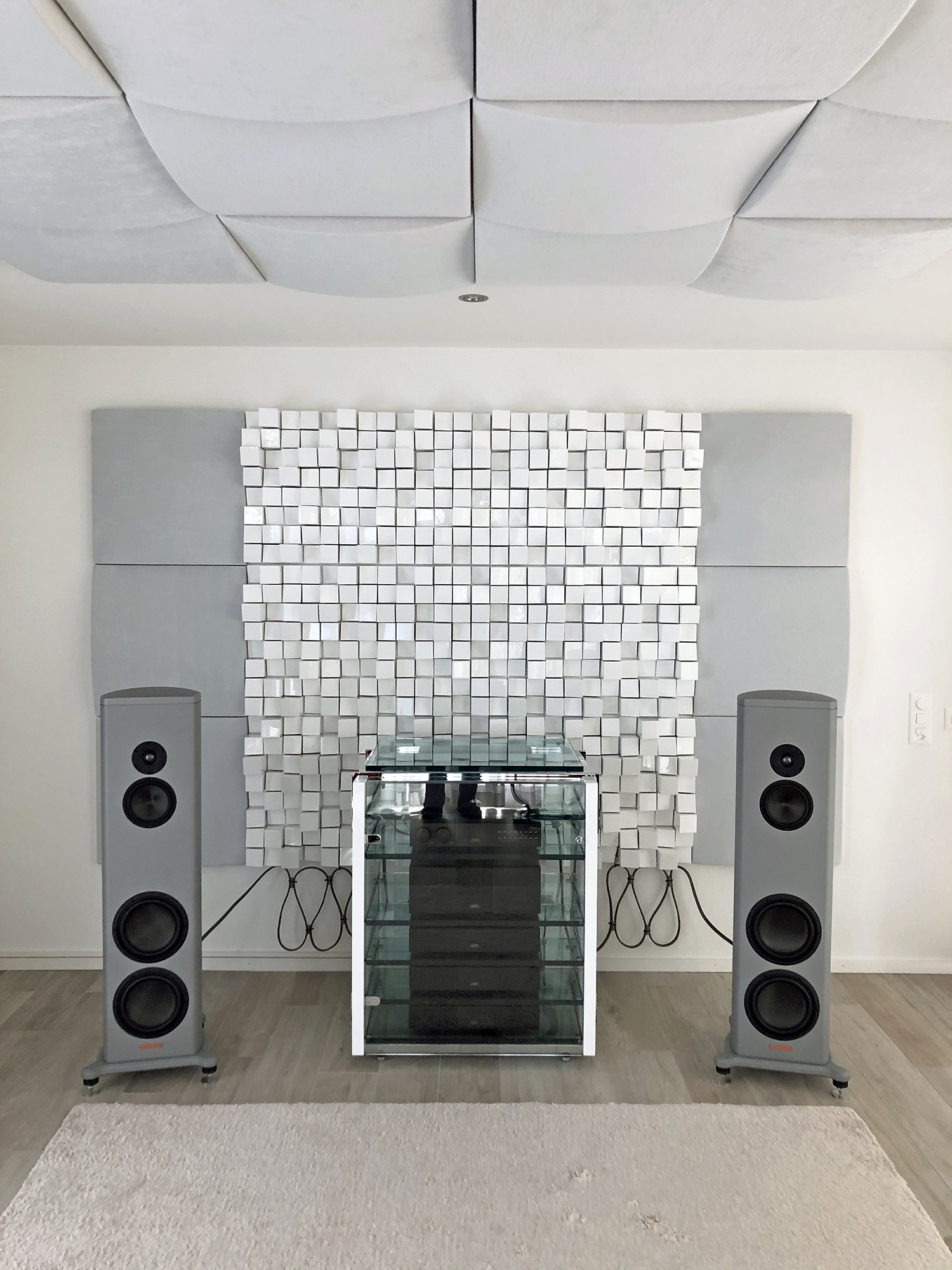

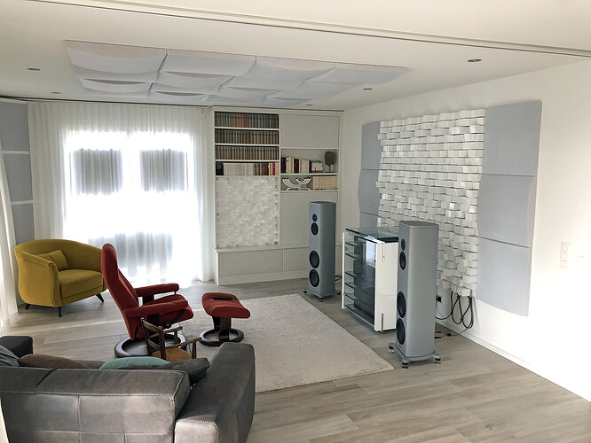

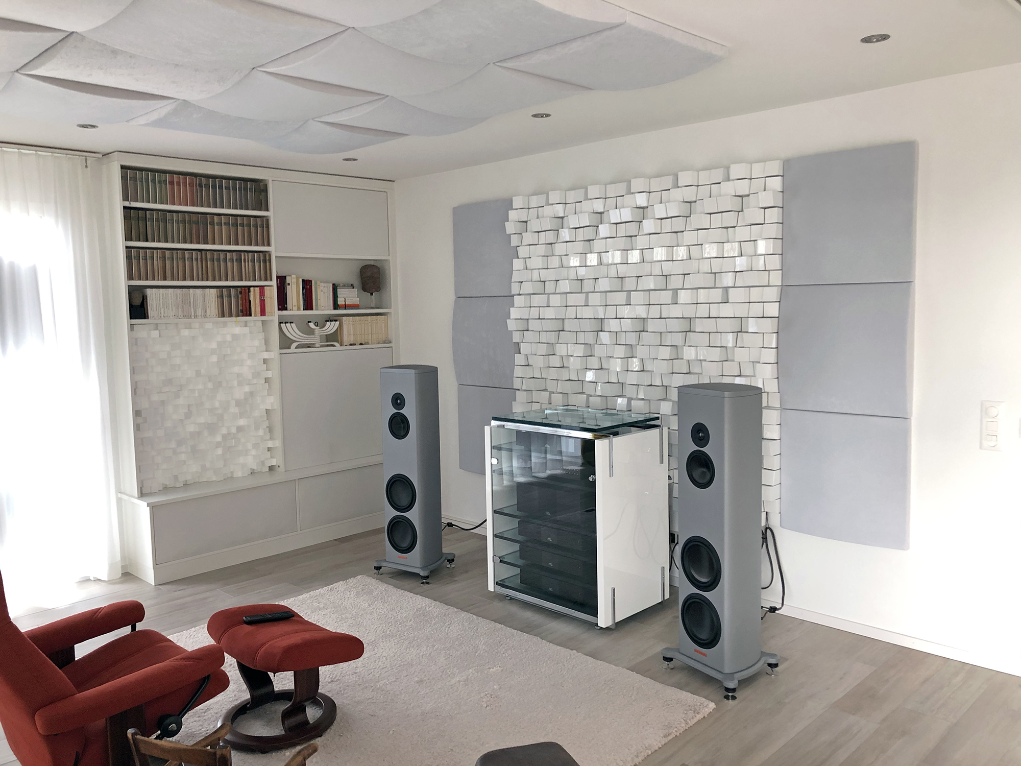

The pictures, at last :wink:
This is the result of 2 years learning, testing, making mistakes, learning again and finally obtaining the desired result :sweat_smile:
It is far from being perfect (compromises…) but it is hugely better.
Apart from being enjoyable for music, the room also became more peaceful. That relaxed atmosphere is quite pleasant when reading or playing with my daughter.
Room size : ~ 38-39 m2
9 x : Vicoustic Multifuser Wood 64 White
Diffusion range : ~125 Hz to 4kHz (probably more)
3 x : Vicoustic Multifuser DC2 white (cute/adjusted)
Diffusion range : 125 Hz to 4kHz (probably more)
Very effective!
26 x : Vicoustic Cinema Round Premium
Absorption range : 160Hz to 5kHz (probably more)
2 x : GIK Monster Bass Traps (in the bookcase – Custom sized)
Thickness 28cm – Absorption range : ~40Hz to 20kHz
2 x : GIK Monster Bass Traps (in the bookcase - Custom sized)
Thickness 20cm – Absorption range : ~45Hz to 20kHz
4 x : GIK Monster Bass Traps (against back windows – 170cm x 60cm)
Thickness 17cm (standard) – Absorption range : 50Hz to 20kHz
3 x : GIK Monster Bass Traps (No in the pictures- 180cm x 55cm)
4 x : Vicoustic Super Bass Extrem (back corner)
Absorption range : 60Hz to 2,5kHz (probably more)

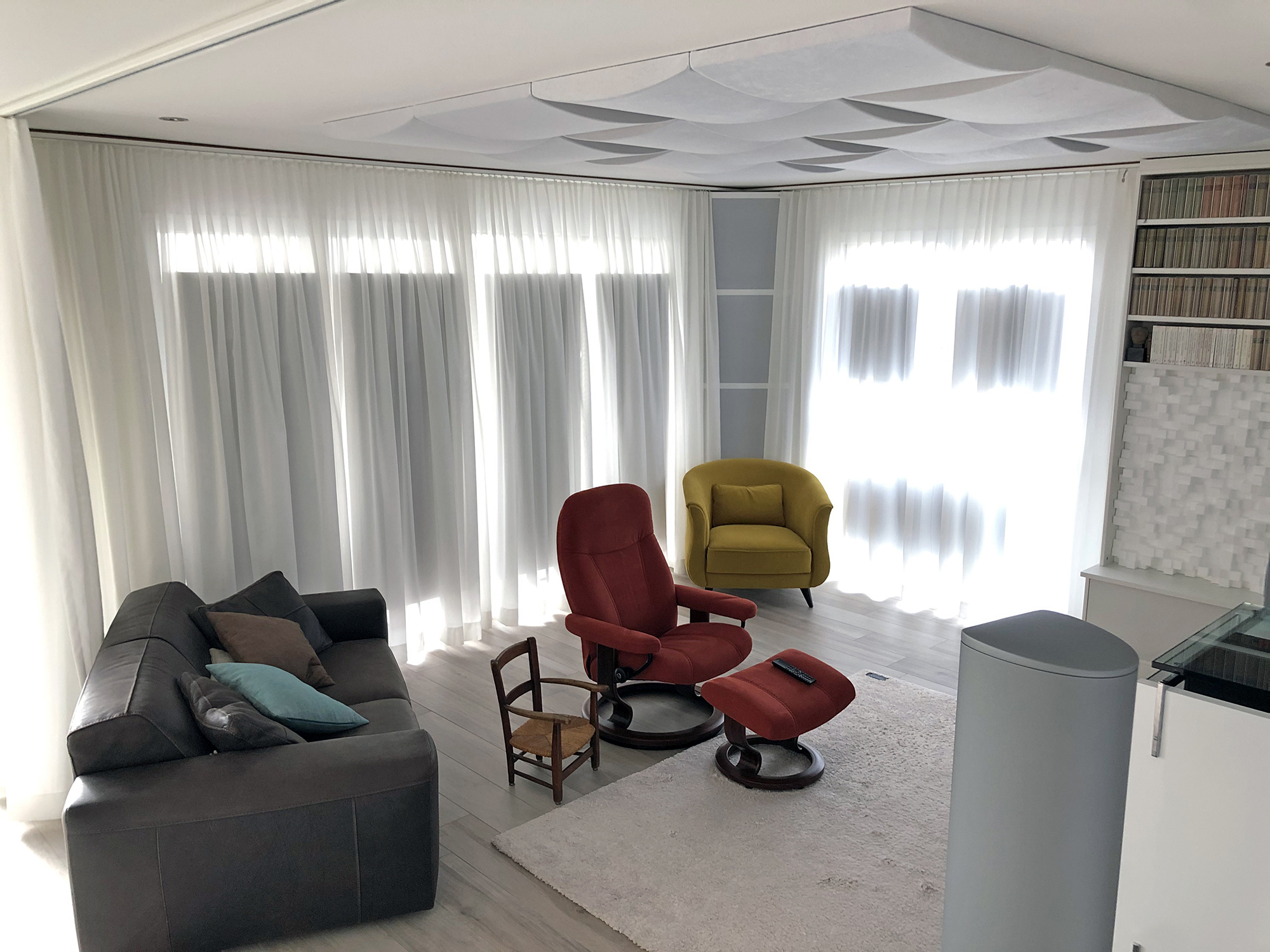

2 x : Streamer Pro Acoustic veils (Annette Douglas AG - Switzerland)
Covering windows
Absorption range : 500Hz to 8kHz (probably more)
1 x : Streamer Pro Acoustic veils (Annette Douglas AG - Switzerland)
Room separation

This was my discovery too when I treated my room , never seems to be mentioned , but a great bi-product of correct room treatment. Relaxing just sums it up , you can just sit and meditate/contemplate/etc in the stillness and quiet.
Great room btw.
Absolutely, this was the unexpected and so very enjoyable bonus.
Thanks :smiley:

Thomas, your room looks every bit as cool, as I thought it would- great job and like my room glad to see, that you still get some daylight in there.
It is very interesting that both you and Folkman have commented on, how it has changed the atmosphere in the rooms. I find myself sitting in there not even necessarily listening to music, pondering over every day life or with my IPad looking out into the garden. There is a really serine atmosphere in the room now.All good :+1:t3: Peter

This was a concern when I ordered the Monster Bass Traps. Despite their size, 170cm x 60cm, daylight comes in sufficiently. These “traps” made an immediate and significant difference.
Back wall and ceiling treatment made the biggest improvement. I have some regrets regarding the front wall. Not sure diffusion was the best choice considering the distance between the front wall and the back wall :thinking:
Indeed, serene is the appropriate description.
My wife and daughter appreciate it very much, mostly just for sitting there and reading.

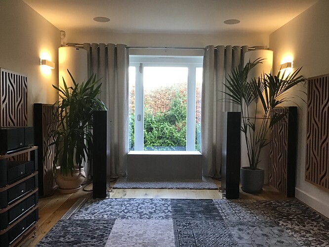

Hi Thomas.
Interesting observation which I can very much relate to. I put 2 QRD diffusers up on top of my big floor absorber resting against my front wall middle glass door equivalent of 1mtr. square ie. listening height. Thankfully I came to the conclusion ( view to the outside retained) that the difference was virtually inaudible. I have however managed rear wall well for 1st reflection. I am now using my QRDs for sidewall reflections purely determining location, if I can actually hear it makes a difference, thankfully having now reached a place with my room, where it boils down to fine tuning. :nerd_face: Enjoy your Sunday Peter
The ‘alien’ / ‘robot’ on the left wall is a bit disturbing, but then if they like the music being played I suppose it’ll all be OK! :laughing:
The magic of light.
These eyes and mouth are 4 Vicoustic Cinema Round Premium absorbers staring at the listener and eating the unwanted reflected sound… if not the listener :jack_o_lantern:

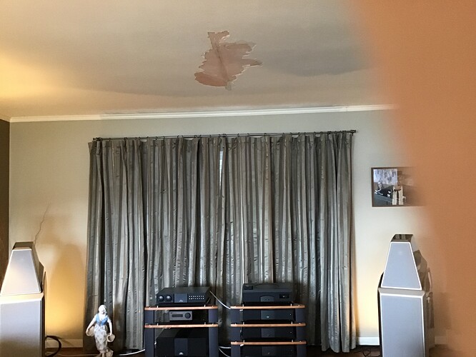

Turned up the hifi too loud. Those Sashas and my 500 blew the plaster of the ceiling. :grinning_face: Time for some room treatment.
Room treatment or acoustic room treatment ? I feel it was a joke Dan, yes ?
Yes, funny?
I had a bath leak up stairs.
Crap, I had the same last year into my media room/office.
