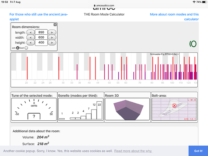

The absence of low bass, or severely diminished, means no problems down there to deal with (and no music to hear, or only faintly) - but the speaker goes low enough to cause resonances due to standing waves in smaller rooms
Unless the speakers are highly directional, not radiating sideways or up/down, then early reflections from ceiling, floor, side walls and rear wall have the same negative effect on sound quality regardless of size of speaker.
I went searching on the web and in text books.
What I found is that there is no perfect room.
But there are better problems :sweat_smile:
In other words, we choose the problems, not the room.
The room needs to be big enough in order to obtain longer horizontal reflexion times and, of course, an even room mode distribution.
Having a ceiling at ~4 meters, or more, seems to help a lot, for the reason mentioned above.
To put it simple 8,5 m x 6,5 m with a ceiling at 4 m seems to be a “minimum”.
Then add to each dimension at least 1 meter for room treatment (I mean built in the walls). Something like:
Carbon Absorption Wall - CAW – Acoustic Fields
In such a room, I’m pretty sure that a 20K euros system sounds better then a 1 million euros system in a normal 45 square meters living room.
Unfortunately, in Switzerland, real estate is extremely expensive. Digging 1 meter more in order to get a nice basement with a ceiling at 4 meters could cost the price of a Naim Statement :flushed:

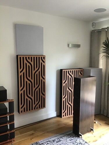

Let’s talk ceiling :wink: I revisited the ceiling one last time week before last. I fitted spare Vicoustics on ceiling 1st reflections ( my dear wife equipped with mirror on a ladder- she was brimming with joy I tell you, because this wasn’t the first time :roll_eyes:) and felt a duvet had been put over the leading edge on guitar replay. Needless to say the Gaffa tape took the paint with it on removal. Then I tried 10mm old fashioned wool carpet underlay nailed in- finally 5mm sheeted lambs wool. Every time I could hear the difference, but I simply didn’t like it!.. and then I spent 2 hours repairing the ceiling :zany_face:
I have tested my own upper hearing with pink noise and I cannot hear a bean beyond 11 KHz and also suffer Tinitus some days worse than others. This in fact doesn’t seem to disturb the listening experience much, as you clearly can’t hear the ‘ jet like noise’ when the music takes over. I am sure my room could be made to sound more ‘ correct’ if you like, but being retired from dentistry spanning 35years with a dental turbine stuck in my ears ( well, not literally as I would otherwise have been struggling to make much of a living), I have no doubt that this has messed with my hearing. Maybe I simply need that reflection who knows?!
The reason for posting above picture is to show that the Vicoustic panel resting on top of the GIK Impression panel for some reason seems to kerb some reflections more pleasing to my ears than the ceiling itself. I do feel that it is important, that we individually tune our rooms to our liking, as we all seem to hear things differently, but also listen to very different genres of music ( It is blues my end).

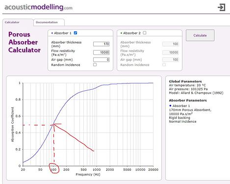

The laws of physics are a reality commonly ignored. Room interactions are always a problem, especially unders 100 Hz.
“Bass traps” are often made out of porous absorbers, meaning they should be instead considered as broadband absorbers.
A typical 17cm thick “Bass Trap” absorbs down to ~100Hz then starts losing its effectiveness, as illustrated below :
The amount of porous absorber needed to absorb under lets say 50 Hz is simply immense!

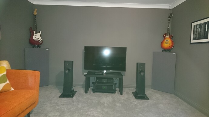

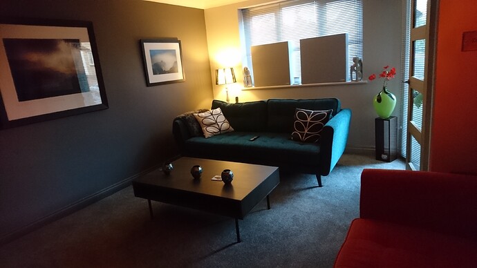

My humble room treatment. Modified height tri traps fron GIK double as nice guitar stands. Also have a couple of monster traps for the window cill behind listening position. Unable to listen to effects properly last night. Will report back over next few days.

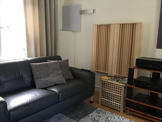

A question for PeterR , as I believe you have a couple of QRD diffusers in your room.
The main benefit of these appears to be to make the room seem larger which i think you found.
But nowhere can i seem to find any reference to what effect , if any , they have on the actual sound. Do they alter the imaging size , is it more diffuse , more solid , greater depth , or anything else. The only piece i did read was the suggestion that without QRD the sound is more like a direct feed from a recording booth , whereas with QRD more like a theatre.
Just wondered what you found , any input greatly received.
Hi Folkman, as per my photo I have used them to pick up part of the opposite channel’s reflection, so in theory to prevent a second reflection on the back wall and the little exposed area I’ve got of a partly covered up window by curtains and a GIK diffuser/ absorber resting on the window ledge. On the equivalent area the opposite side to the QRDs I am using 2 Vicoustic panel absorbers similar to what Thomas has used on his ceiling. In my photo you can also see it above the GIK Tritrap again in both corners to prevent image shift.
My QRDs are according to the Polish manufacturer effective between 550- 5500 Herz and you get a fanning effect more so by using several panels mounted next to each other. You also need to be more than 5 feet away from it to get the sonic benefit.
I have been a funny bugger, when it comes to treating my room, as I have been reluctant to absorb too heavily or in other words, I have tried to keep my room as lively as at all possible once I felt my reverberation was good. I tried Vicoustic absorbers in their place but strangely but preferred the QRDs. I guess you probably need a lot of them to truly hear their liveliness benefit, or the perception of the sidewalls disappearing if you like. This is all very personal and as always there could be an element of ‘ The Emperor’s new clothes’ in the way I have used them.
I know above isn’t of much help sorry, but if you want to hear more about them, you could check out acousticfields on YouTube, where Dennis Foley talks quite a lot about them and also seems to have used them a lot in his installations.
In my case I feel my room is very much allowing the music to wrap around me as in a horse shoe type scenario, if that makes sense. Is it partly down to the QRDs… dunno? I am certainly very happy about my room/ speaker interaction now and have no intent to carry a long exhausting journey on tbh. :sweat_smile: ATB Peter
As my good friend and ex Forum member J.N would say; “ You could always suck and see”!

So after a couple of weeks with two tritraps on the front corners and two monster bass traps on the window ledge behind listening position the improvement is significant. I am particularly impressed with the monsters on the rear wall. They seem to pull everything together really focusing everything and particularly improving percussion. This really is minimal room treatment without anything for first reflection points but the improvement is significant.
Can I somehow negotiate a few more panels??? :joy::joy: Maybe put some curtains up with some 244s behind them!
