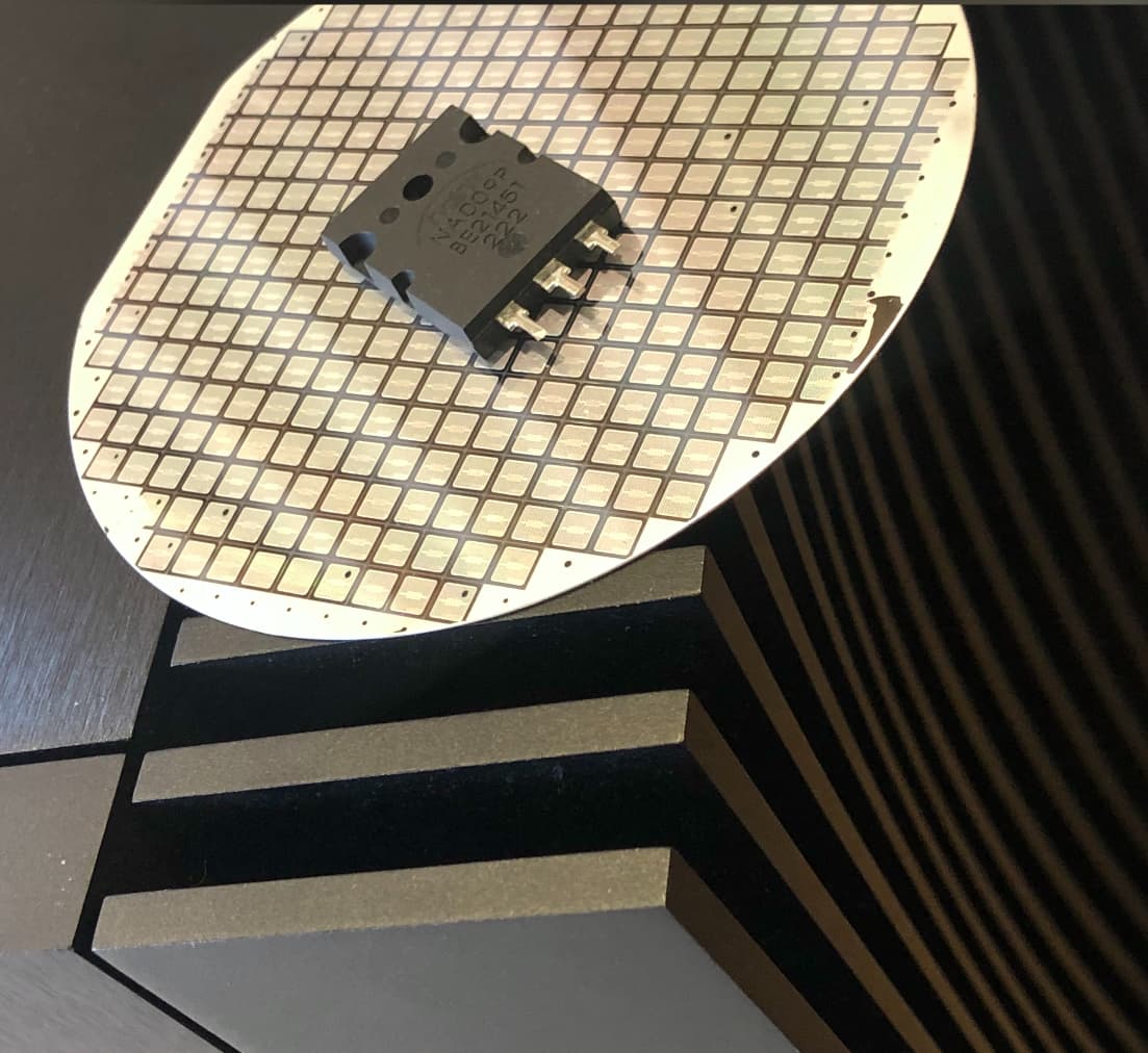

Being fanatical and curious engineers/audiophiles we wanted to break the 140W power ceiling. Statement gave us the opportunity. Going back to first principles says ‘use bigger transistors’, however there are none suitable for audio; could we make one?
We worked with our transistor manufacturer to find a solution. The result was to use adjacent die (die are the individual transistor on a silicon wafer) and make a single large composite transistor. Being adjacent die the two transistors have near identical characteristics and in parallel essentially work as one larger transistor.
(Below shows a wafer and an NA009 for a sense of scale. NB: this is not the NA009 wafer but the first I could get my hands on this morning and is representative, the squares are the die)

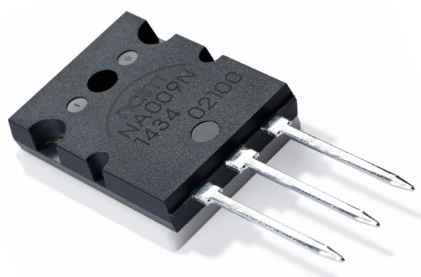

Fast forward through development and the final result was to split these into separate packages for practical reasons and allowed the use of a non-ferrous. transistor legs.
They were serial numbered so the ‘single large’ transistors could be reconstructed at the Naim factory. The NA009 was born.

Very interesting I wonder are these only used in the Statement Series or is there any trickle down.?
Thanks.
NA009s?
They have also been used in the NAP250DR, 300DR, and 500DR and also used in the New Classic NAP250 and NAP350.
