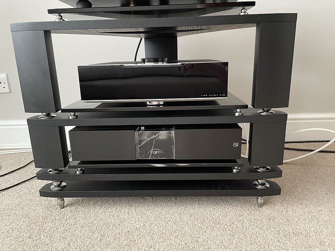

The deed is done, just fired up. I’m suitably impressed already and beyond happy with the change.
Certainly looks a good pairing (apart from protective film but easily remedied :joy:).
Interested to hear your thoughts compared to previous set up, in due course, although my 200 gear hit ground running according to my cloth ears.
Enjoy :blush:.
Well spotted, I literally plugged it in (kids tennis lesson and dinner in the middle) and took a photo!
It’s a brand new unit, never played through till today, considering that it’s pretty damn good, importantly it works favourably with the existing speakers and room setup as a bonus.
I had the foresight to measure the height of the DSM and order medium Fraim legs at the same time thankfully.
More to come as you know…
