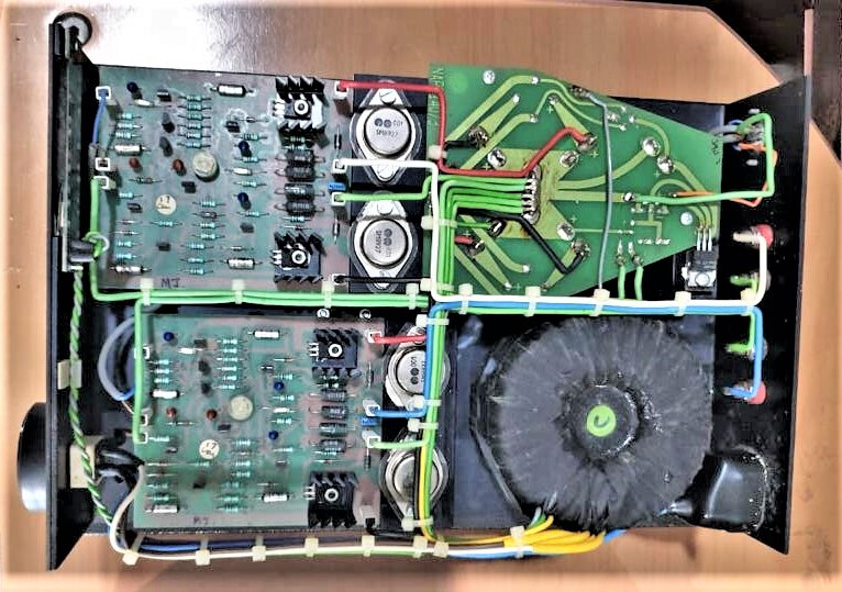

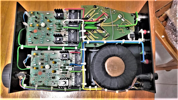

I have 2 option of NAP 140 :
NAP 140 Chrome Bumper
NAP 140 Olive
which one better to choose considering the condition of both ?
thank you
I can see differences - both the Transformer and the Output devices.
I assume the lower pic is a much later unit…?
For anything more, I think we need the tech gurus on this …
Over to @Richard.Dane and @NeilS … :thinking: :thinking:

Yes, the upper one looks to be an earlier CB NAP140 with the Sanken Output devices and H&F transformer, whereas the lower one looks to be a later Olive NAP140 with the NA001 output devices and a Nuvotem transformer. Performance differences will likely boil down to whether officially serviced recently or not. As to what clues may indicate that just by looking at the pictures, I defer to @NeilS.

Difficult to tell if the older one has been serviced - yellow tants were used many years ago & again since 2005ish (at a guess). However, someone has been in there & installed the green wires. Naim wouldn’t have done it like that & we would have sleeved the IEC inlet & switch.
The newer one looks untouched & original.
It’s down to a matter of personal taste really - do you want CB or olive?

I have got the point and choose CB version of NAP140 (using H&F Toroid)
