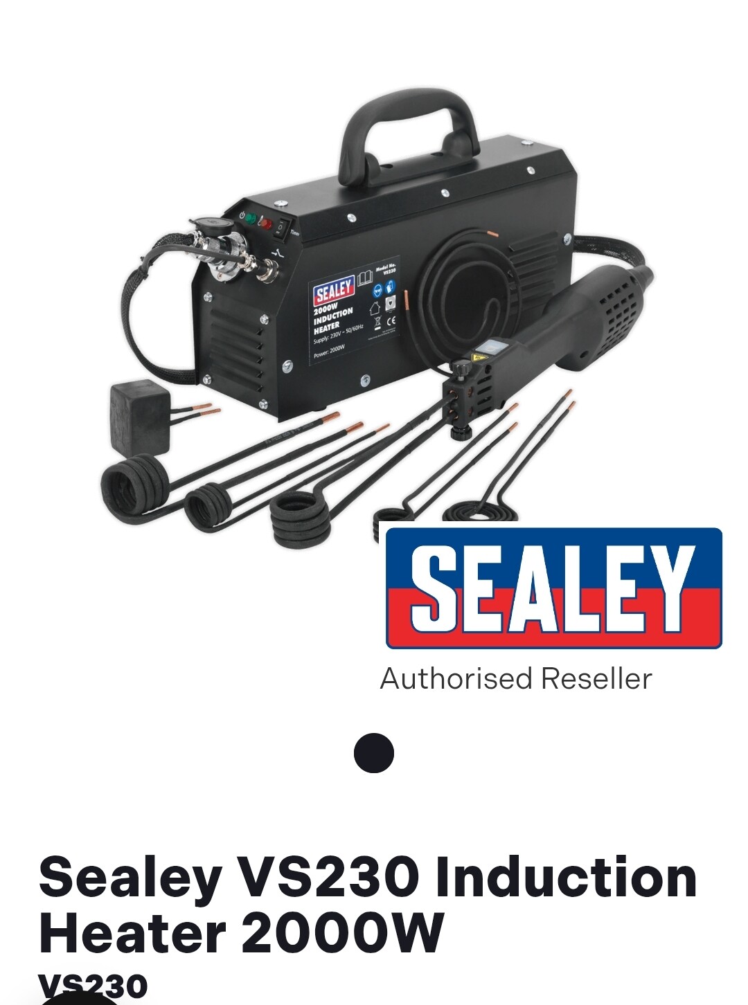

I few months ago I needed my glow plugs replacing, I was getting an error code indicating a glow plug fault.
My mechanic refused to swap them, saying there is a risk of them snapping. He put me in touch with a garage that uses an induction heater to ensure safe removal.
Something like this.
The glow plug fault wasn’t enough to switch on the engine fault warning lamp. But they definitely needed replacing, accelerating is now a lot smoother.
