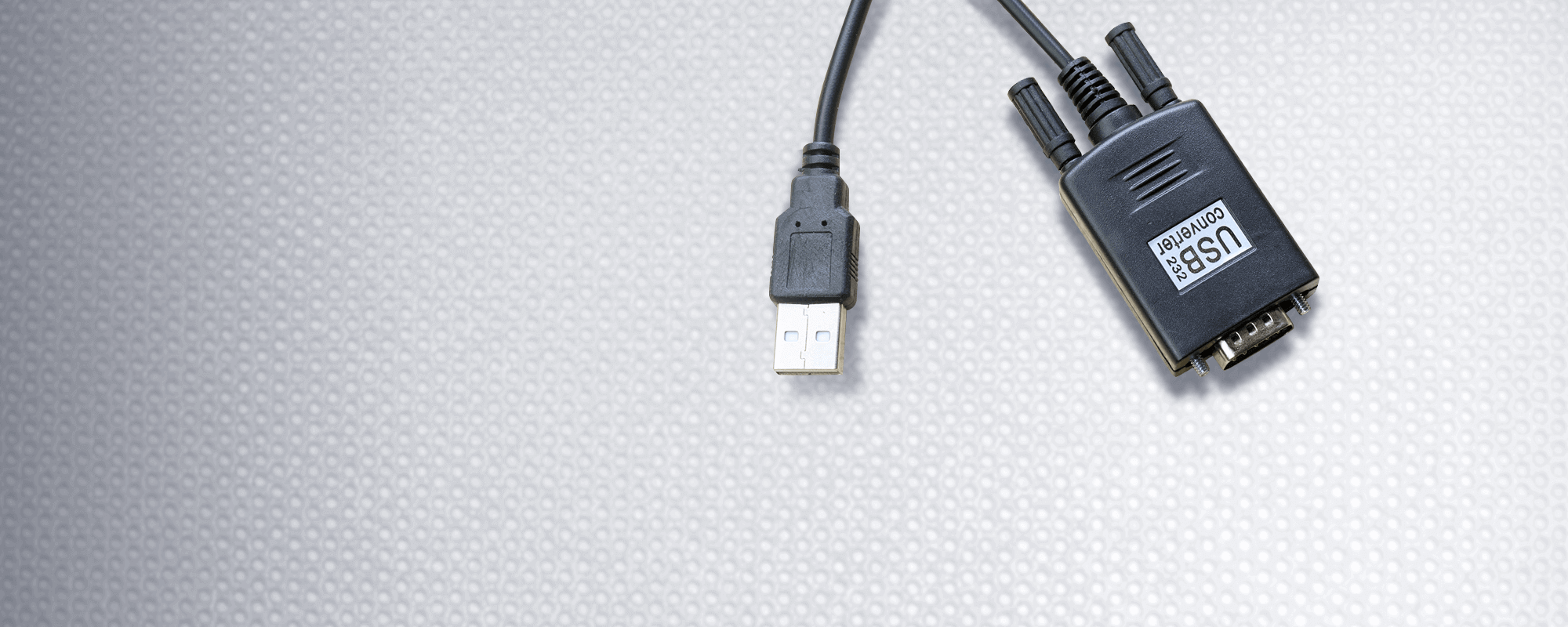

Thank you! Am working on the upgrade of the firmware. Next issue is that the naim streamer updater does not see the usb port. Any idea how to fix this? Thanks, Ron
You will need to install the necessary drivers. Please read the pdf it has all the information.

thank you, i am denied access to the driver update manual
I could select the port after finding the right usb driver software. This chat may be closed! Thank you, Ron
