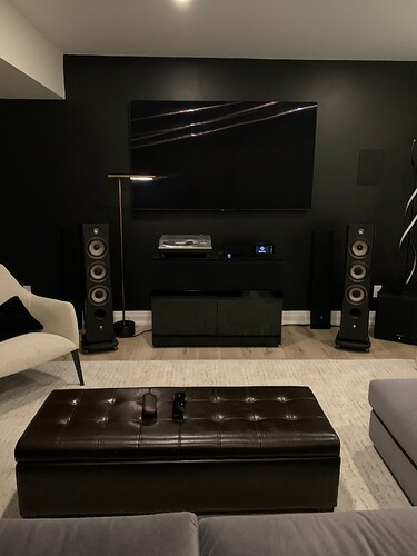

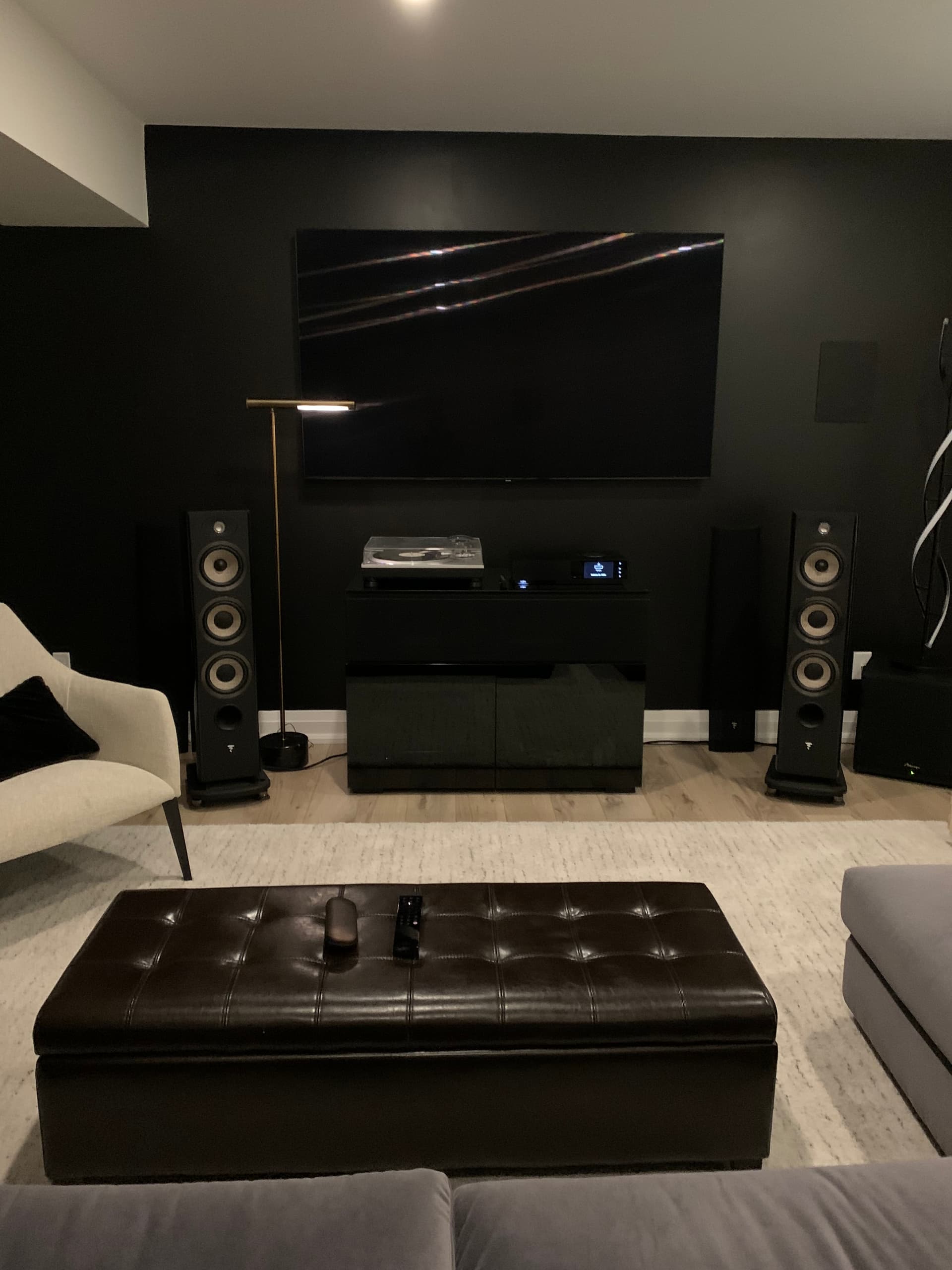

This is exactly a thought I’m having. I run Focal Chora 816 with my Nova. They sound really good. I have a Powerline and Isoacoustics under the Nova and speakers. The idea of Kanta or Sopra sounds tempting but I really think if I add a sub I’d get in the neighborhood for waaaay less money. But actually, it’s sounds pretty darn good now which is why I haven’t yet.
