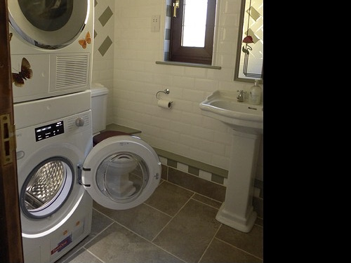

The tumble dryer can be stacked on top of the washing machine. Miele do a washer-dryer stacking kit with integrated drawer which is very handy.
So if the garage location is too cold, perhaps put the drying indoors over the washer.
My Miele heat pump dryer works really well, the only issue i have is it tends to tie my duvet cover into a knot very quickly so need to open the door and loosen it up a couple of times before it’s finished :sweat_smile: …but apart from that it’s a good dryer :slightly_smiling_face: :+1:
I assumed it was on its side and that was why the door is hanging open!
