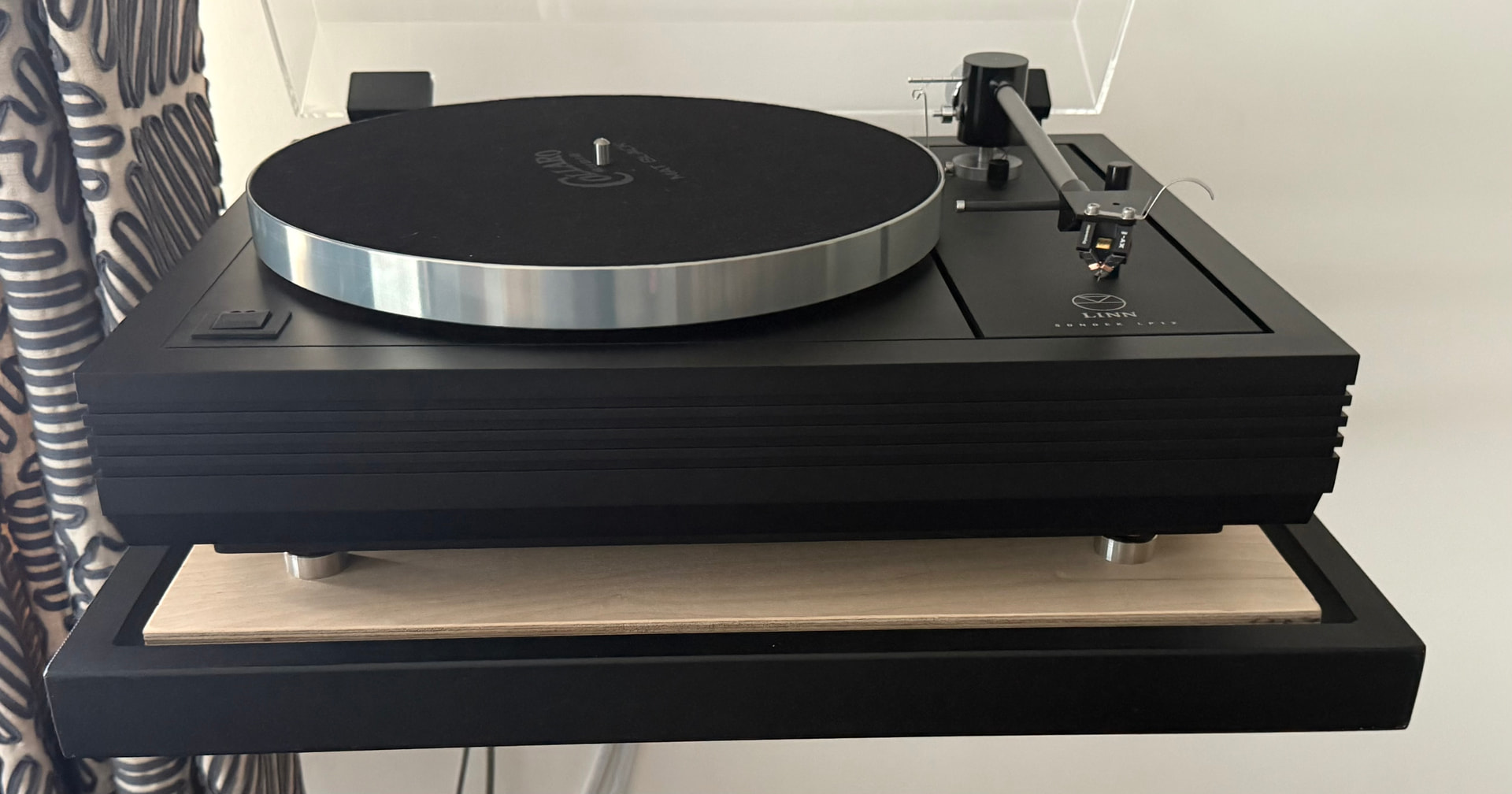

I replaced the standard chipboard shelf that comes with my Target TT1 wall shelf with a piece of 3/4” Baltic Birch Ply often used in speaker manufacture. B grade so £45 for a 2’ piece that I cut down to 45 x 34cm. It’s very dense yet light and strong enough to resist sagging where the rear central foot is on the Tangerine LP12. Sonic improvement over the chipboard IMO. I keep meaning to paint it black.

Thanks. Since I have a Stiletto, this result is ultra-interesting to me. That looks like another cheap experiment waiting to be done. I probably won’t hear the difference, but lose almost nothing by trying.
Could be worth trying to make a skeletal version…
The contrast wood colors is interesting
Breaks up all the black
