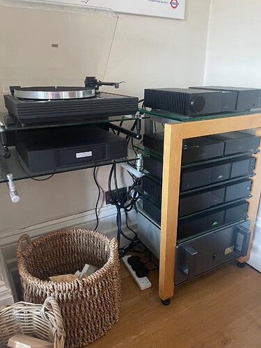

I agree about the importance of good anchoring to the wall. In my room, I’m attaching to an outside wall of a Victorian property - traditional plaster finish over a brick wall. The Quadraspire was bolted to this via 6 machine headed bolts into plugged holes directly into the brickwork. It wasn’t going anywhere soon! As previously mentioned, the concern was more over the ‘arms’ that extend horizontally from the back plate - there is some potential for movement there, I feel. Levelling is fairly straightforward as the glass shelf is adjusted via 4 down facing spikes that sit in recesses in the arms.

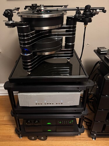

My current turntable, with three arm boards, three tonearms, record weight and peripheral ring is 145 lbs, and it’s 16” tall. I would never consider putting that on any kind of wall shelf, and I doubt one exists for that kind of load. I now use a HRS EXR rack with a HRS M3X2 isolation base for the turntable. That’s a remarkably stable affair.

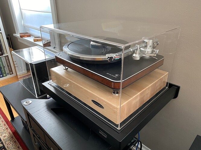

This is an old picture of my Ovation on the WS-5. I also used an isoAcoustics Delos isolation base. With an LP12 you shouldn’t need the isolation base, but YMMV.
This is my current turntable on the HRS rack and isolation base.
A fantastic looking set-up. I can only imagine how impressive it sounds!
It brings me joy every day. :joy:
