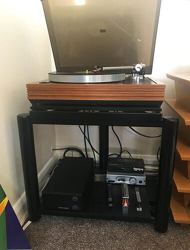

I still use a Sound Factory Turntable Stand, from the 80’s -
That must be a foreshortening of the image, but the Ittok(?) looks far too close to the centre of the LP, almost on the label - which the stylus probably wouldn’t like very much.

Expand the image :mag_right: There’s clear water between the stylus and label - it’s just a perspective thing IMO, as it’s the playing the last track.
I don’t know how to do that, but no matter. As long as the stylus is OK!
