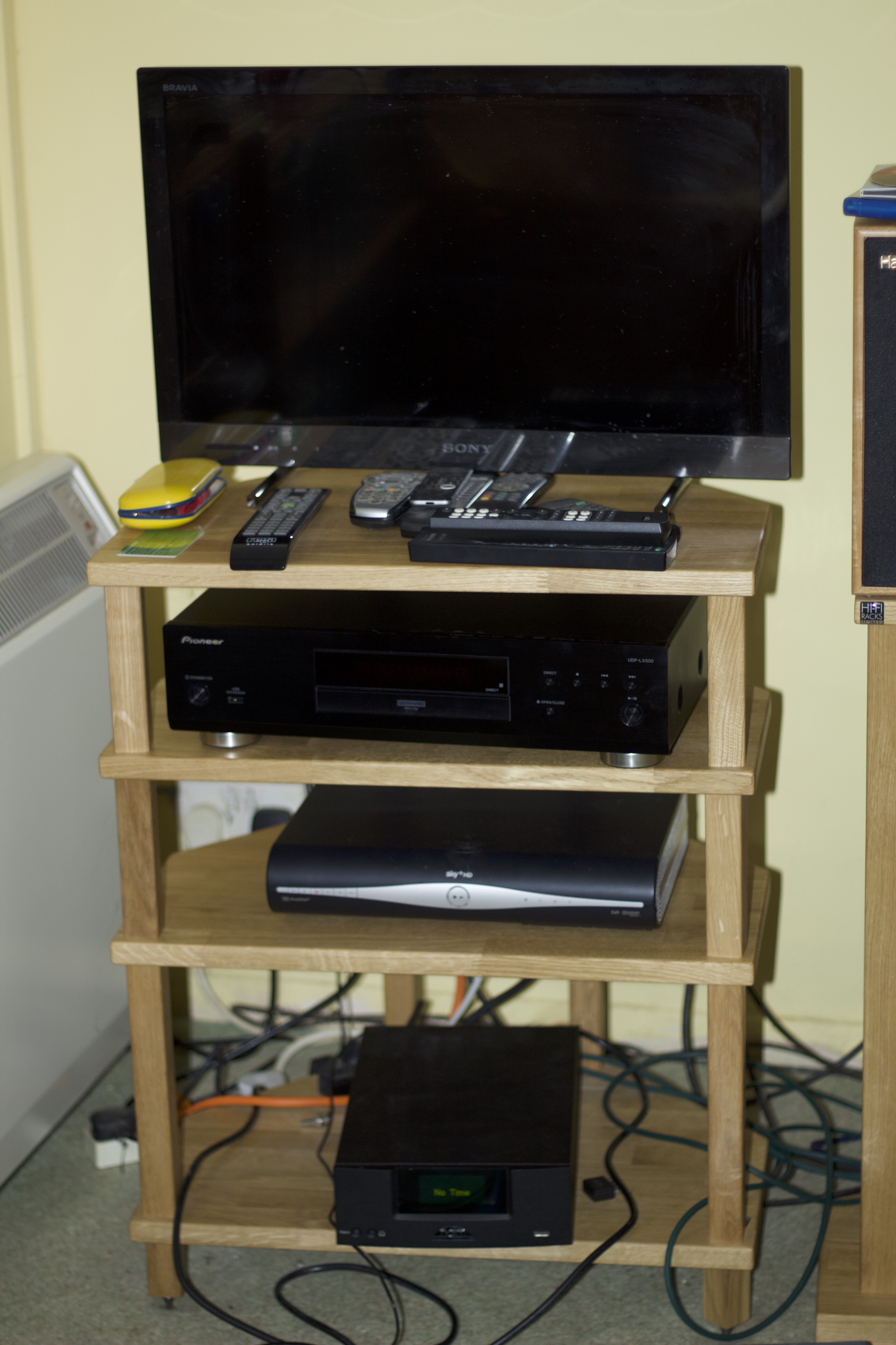

Please excuse tatty photo
Is it only 0.7…? Seemed longer when I tried. tbh, when I turned the buffer off then it seemed okay. However ZERO room for aforementioned Bartok or any speakers has scuppered that idea
I think so ? 0.72 springs to mind , it was hidden somewhere deep in user guide I think . O.7 is a long long time when it comes to lip sync .
