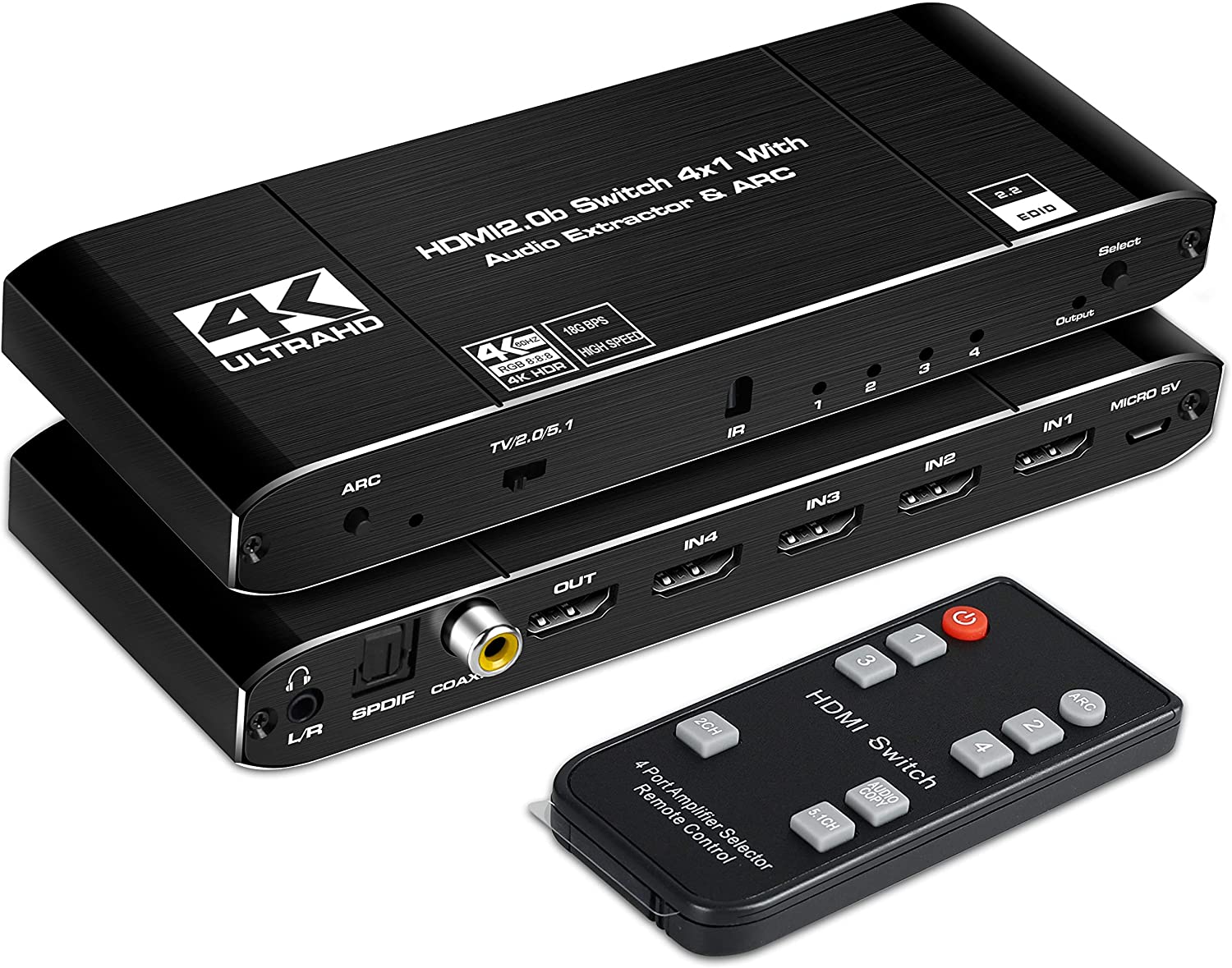

For your scenario, since you have multiple video sources, the best option might be to use an HDMI switch / extractor like @Wayne does. This would bypass all the processing in the TV and depending on the quality of the switch could give you a near perfect sync.
These devices are generally not very expensive (usually not more than $35-50), although some do perform better than others so it’s probably good to read some reviews first.
This is an example of such a device:

Can you just simplify for me how I’d connect things to that before I do some research.
I have a Blu-Ray player, a Roku thing and a Freesat box connected by HDMI to my TV. Would they all connect to a device such as above and then does that connect to the TV via the HDMI ‘out’? How do I get the audio out? Would that still come from the TV jack or from the box above somehow?

That’s right, your HDMI sources would plug into the switch with only one HDMI cable going out to the TV. The switch has audio outputs for analog, optical or coax, in which case you could use the analog one to connect to your preamp. So you wouldn’t use the audio output from the TV anymore.
There might be some switches available also that feature stereo RCA analog out instead of a 3.5mm jack, which might be interesting to look for as well.

That is what I have done (from the headphone socket) Stu but streaming in particular is definitely ‘off’. A switch such as shown above is on the way. Since the TV only has two HDMI sockets if nothing else this will mean we can use the various inputs without having to swap cables over each time!
