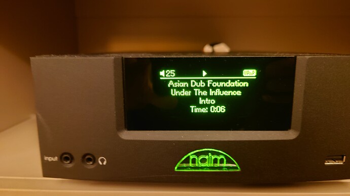

Given the way of things with shortages and items going out of stock, or unavailable, I’m with feeling_zen here, it might be worth getting the screen done whilst you know you can and asking for a quote for a full service at the same time. Here’s what a new screen looks like brightness wise :sunglasses:
