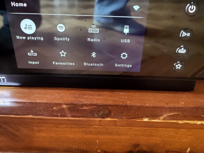

The front panel shows only a WiFi icon with an apostrophe otherwise no message - see photo.
While trying to connect nothing happens on the front panel or the volume button - I had a memory that the volume button should pulse?

The Atom is disconnected from WiFi, correct. That’s the exclamation mark (as I decipher it) on the place, where the WiFi icon should be.
As long as that icon is active, the Atom will not show up on the network.
So, when you changed the router, either the SSID for the WiFi changed, the password changed, or the Atom ran into some other situation preventing it from connecting.
When you have the remote at hand, go to settings → network → WiFi setup (or similar, I have another language on the system).
From there it should be possible to connect the Atom, without any need to reset things, etc. pp.
(Not sure, if the wizard for setup via a phone will trigger; worst case there’s the tedious activity to enter the password for the WiFi via the remote…)
