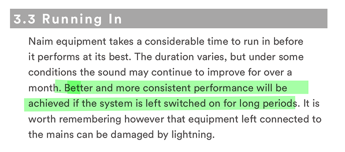

As for the manuals and notes on keeping your system running: Naim still include a sentence to that effect in current manuals (eg Supernait 3). I wouldn’t attach too much importance to the fact that the “interactive” Uniti manuals don’t mention anything along those lines – IMO, these manuals were a shambles on several levels, a bloated, technically cumbersome system of providing fairly simple information.
Not sure I would agree with that. The fact that very low power consumption in standby mode is required under legislation means that Naim cannot really allow you to have the unit fully powered up, as recommended by them for optimum performance. They have pretty much admitted that server mode, or an attached USB device, is a workaround that allows you to keep the main PSU warmed up should you choose to prioritise performance over electricity consumption.
Hi Chris, of course it is possible that keeping the unit powered up as a result of server mode contributes to better sound quality, but that will then apply to every mode of playback. Obviously, if someone has their unit set to “enter standby after x minutes of inactivity” and listens to USB direct for weeks, then activates server mode and listens to USB via Ethernet for another few weeks, they may could to the conclusion that a better SQ comes from having kept the unit warm for the latter scenario.
It’s simple to eliminate that uncertainty factor, though, and to compare USB direct vs indirect via Ethernet – either on a unit that’s been powered up for ages or one that’s just been turned on. You can even deactivate server mode for USB direct without switching the unit off if you want to keep the comparisons fair.
Perhaps I’m missing something, but why would you need server mode as a workaround? If you want to prioritise consistent sound quality over energy saving, just set your unit to never go into standby. And make sure your pets can’t reach the power button :slight_smile:
It does, from the horse’s mouth:
