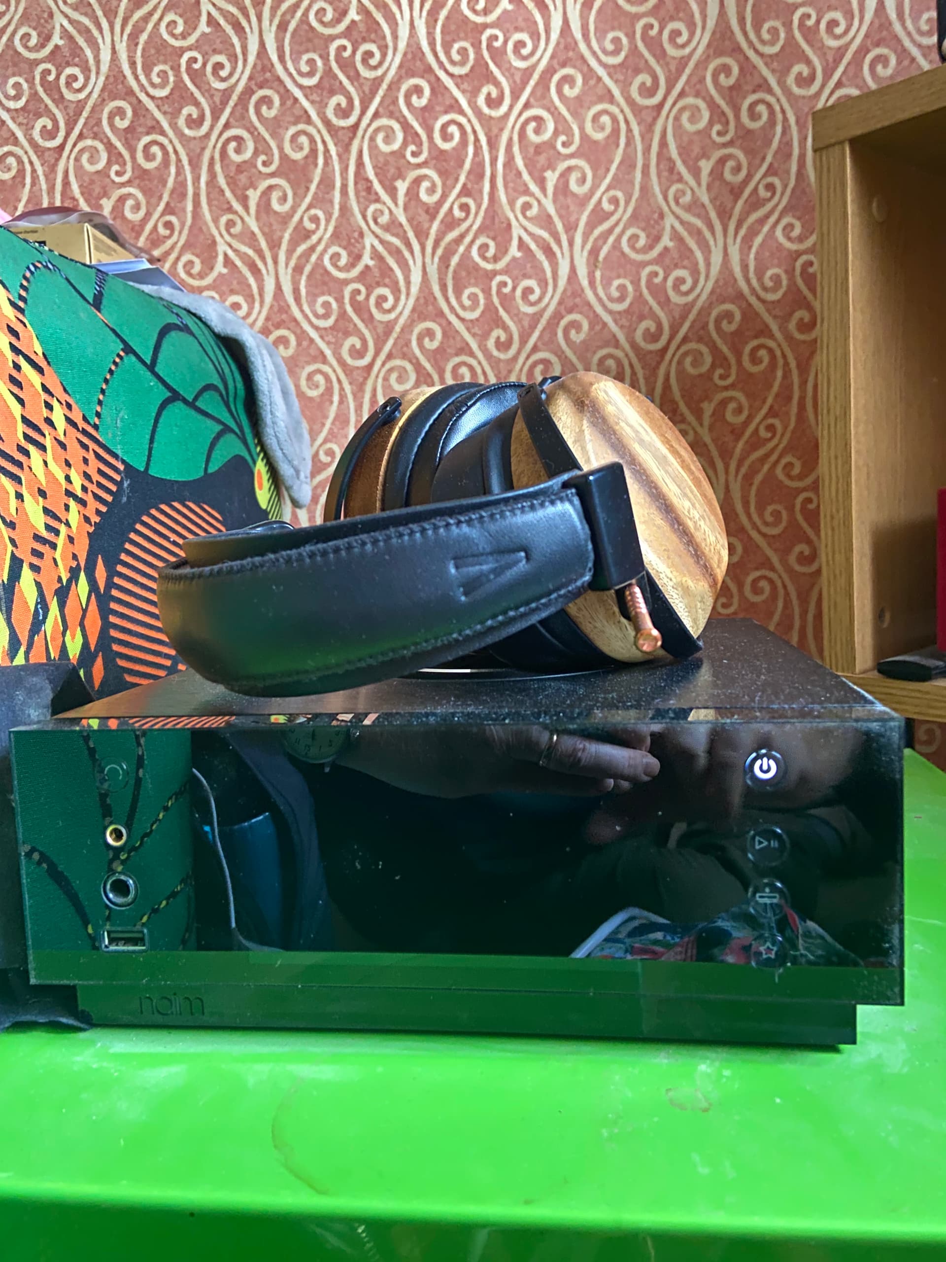

When you put the Atom into standby the on/off button glows, but the Naim logo doesn’t. I think the only way would be to cover the button with a black vinyl sticker. But this could make a sticky mark. I don’t find the glow obtrusive, but I don’t use my Atom in the bedroom. (Picture of standby)
And as PhillipVH says above if you change the input or volume the screen will illuminate.
