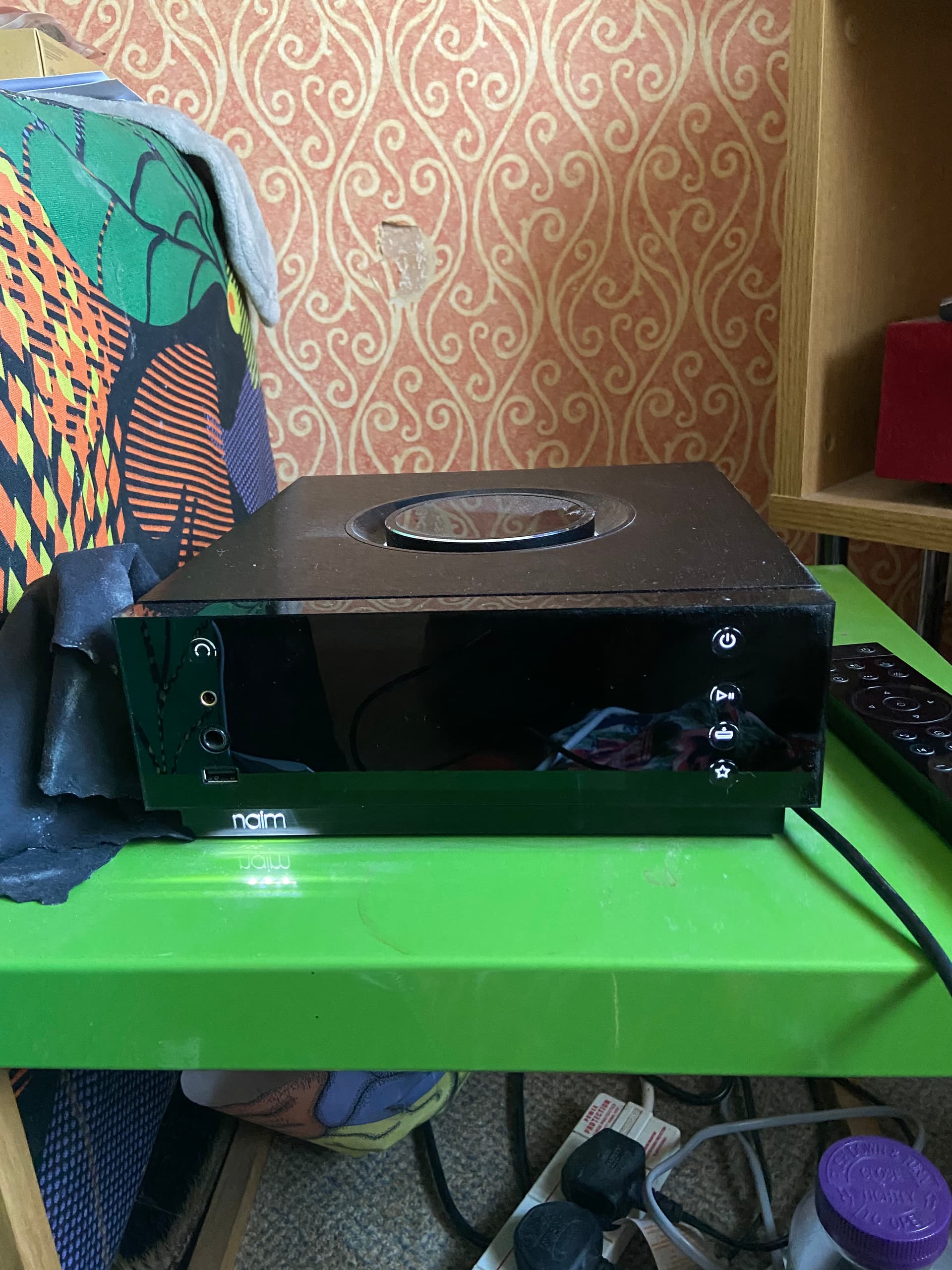

This might be an issue in the bedroom :slight_smile:
How much can the buttons be darkened during usage - maybe it is similar to muso?
Hmmm - must can dim naim logo and the ring totally.
When playing with no screen display the volume ring is illuminated and all four of the Atom control buttons. There isn’t a complete dark mode as far as I can see anyway.
