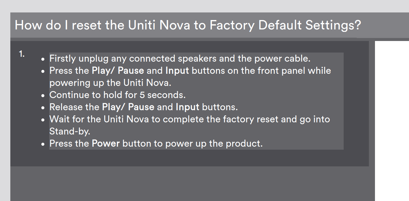

I fixed it with a factory reset: “Anyways, a factory reset fixed it now.”
However, it may not be necessary as somebody else got this info from Naim support that a soft reset may fix it so try this first:
**4-2-5 power button flashing: **
Streaming board failing to initialise
Had/having similar issues with my ndx2. Reported the issue to Naim tec support who advised the following:
Sequence of 4 then 2 then 5 power button flashing: Streaming board failing to initialise. Pull power plug out press top and bottom buttons whilst putting power lead in again and keep holding until screen turns on. This is a hard reset. For a soft reset do the same but with the middle two buttons.
You’ll need to repai…
If you do have to do a factory reset, note that this loses all settings: https://www.naimaudio.com/product/uniti-nova/support
As far as I know, this problem is also expected to be fixed in the upcoming firmware update.
