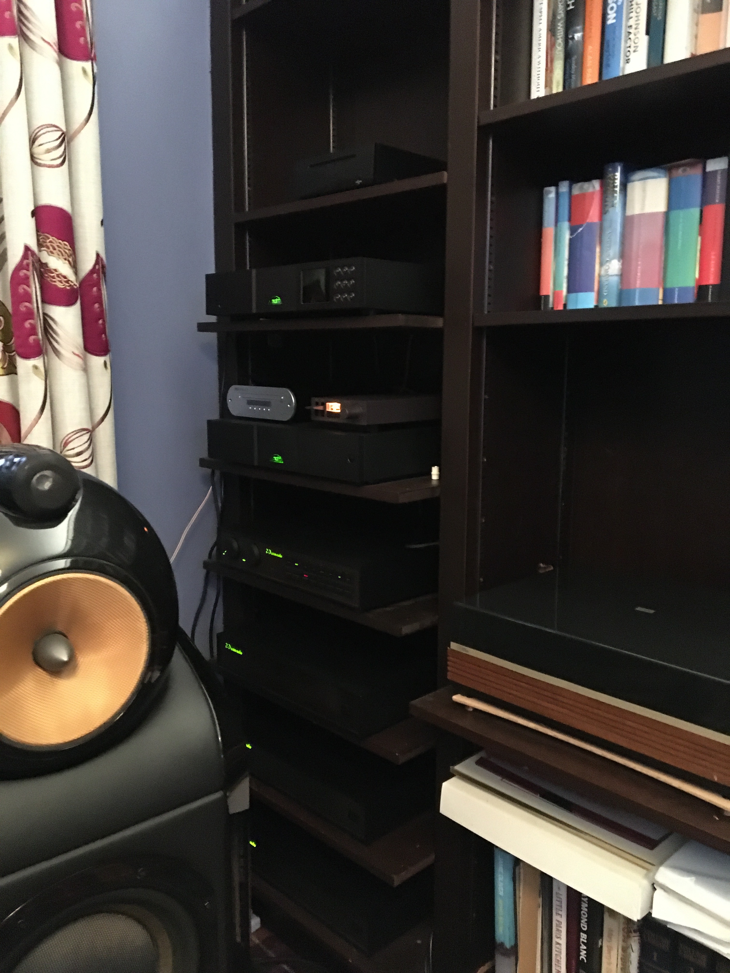

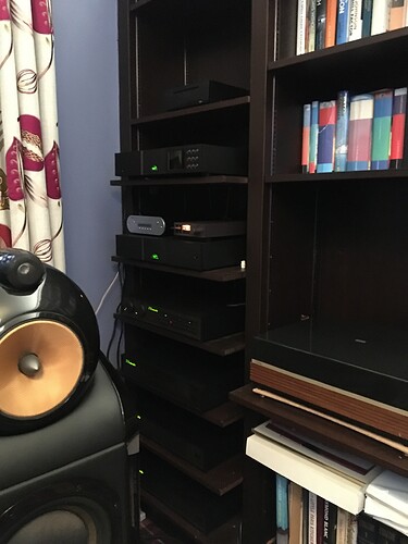

Here’s an NDX XPS2 with a 52/SC/135 system. I wouldn’t change the amps - Naim’s flagship system until a few years ago. A Supernait is fine, but not in the same keague.
Get a secondhand NDX and XPS2 and you’ll be fine. The XPS2 doesn’t add all that much anyway.
