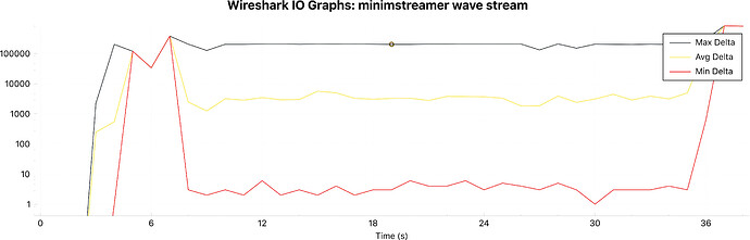

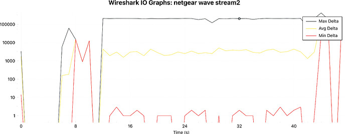

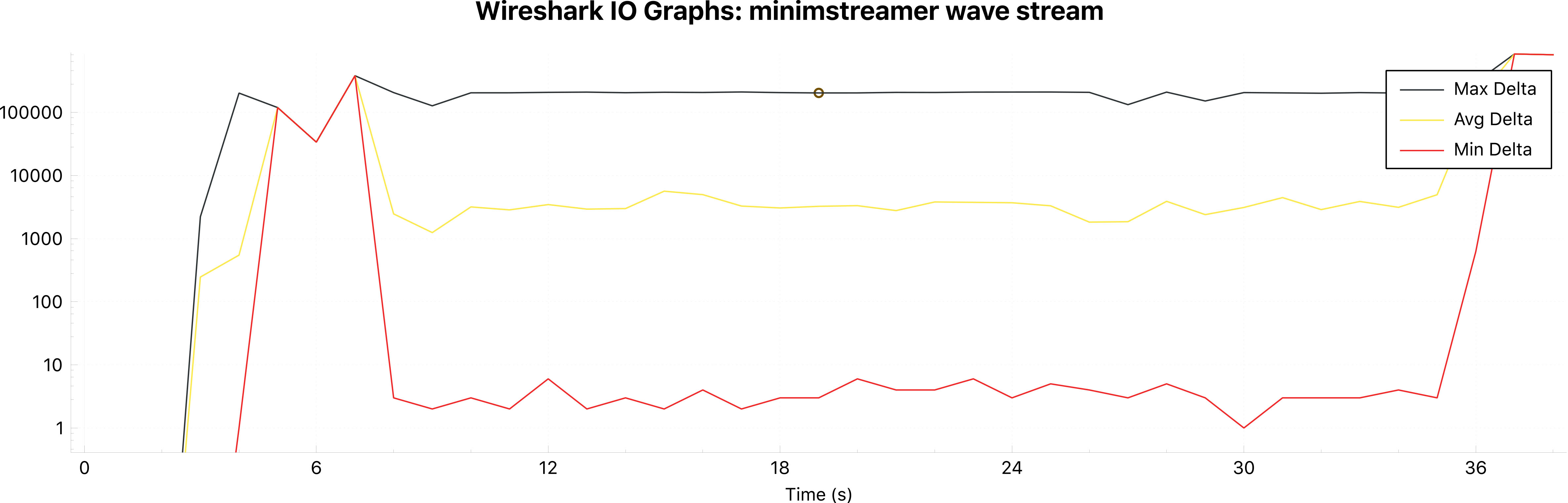

I created some wireshark macros to explore this further. Look at the red line which is the minimum time between frames in media transfer bursts
An Example of Minimserver on RPi
An Example of the DLNA Server on a RN02
In these examples the latter sounded preferable on the legacy streamer.
