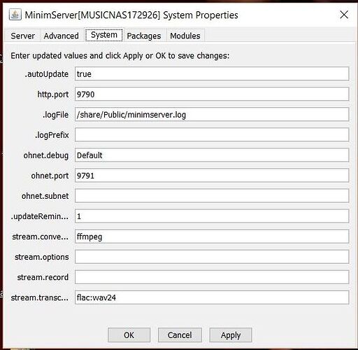

On all platoforms? where this can declared on QNAP? I am reading documentation and says that needs ffmpeg installed
Not exactly, one has to install the MinimStreamer extension to MinimServer in order to transcode .flac files to .wav, see https://minimstreamer.com/.
After installation, simply enter “flac:wav” in the stream.transcode field of the “System” menu via MinimWatch.
I am trying right now to configure this on QNAP via command line. I have managed so far to install static version of ffmpeg program in the appropriate directory/share/HDA_DATA/.qpkg/MinimServer/opt/bin]
Now remains (i think) to find where i put flac:wav option…
I can see a line with stream.transcode = flac\:wav in minimserver/data/minimserver.config but I never edited this file directly. I have configured MinimServer using MinimWatch, as explained above.
It should look like this for flac to wav.
“flac:wav24” means that 16bits files will be converted to 24bits files, however.
If you only want to change the format by leaving the sample rate and the bits depth unchanged, the setting is “flac:wav”, I believe.

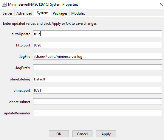

Today i continued my minimserver research. I installed minimwatch on my windows 10 desktop in an effort to configure flac:wav conversion but i can not see all options that appear on Peter1480’s screenshot
This is because, as explained above, you have not installed the MinimStreamer extension to MinimServer.
Thanks a lot, i installed MinimStreamer from MinimWatch and missing options appeared!
A little confusing procedure because i installed something on QNAP server using a Windows program…
Great, at this point you should have no problems setting up MinimServer according to your needs. Enjoy, nbpf
