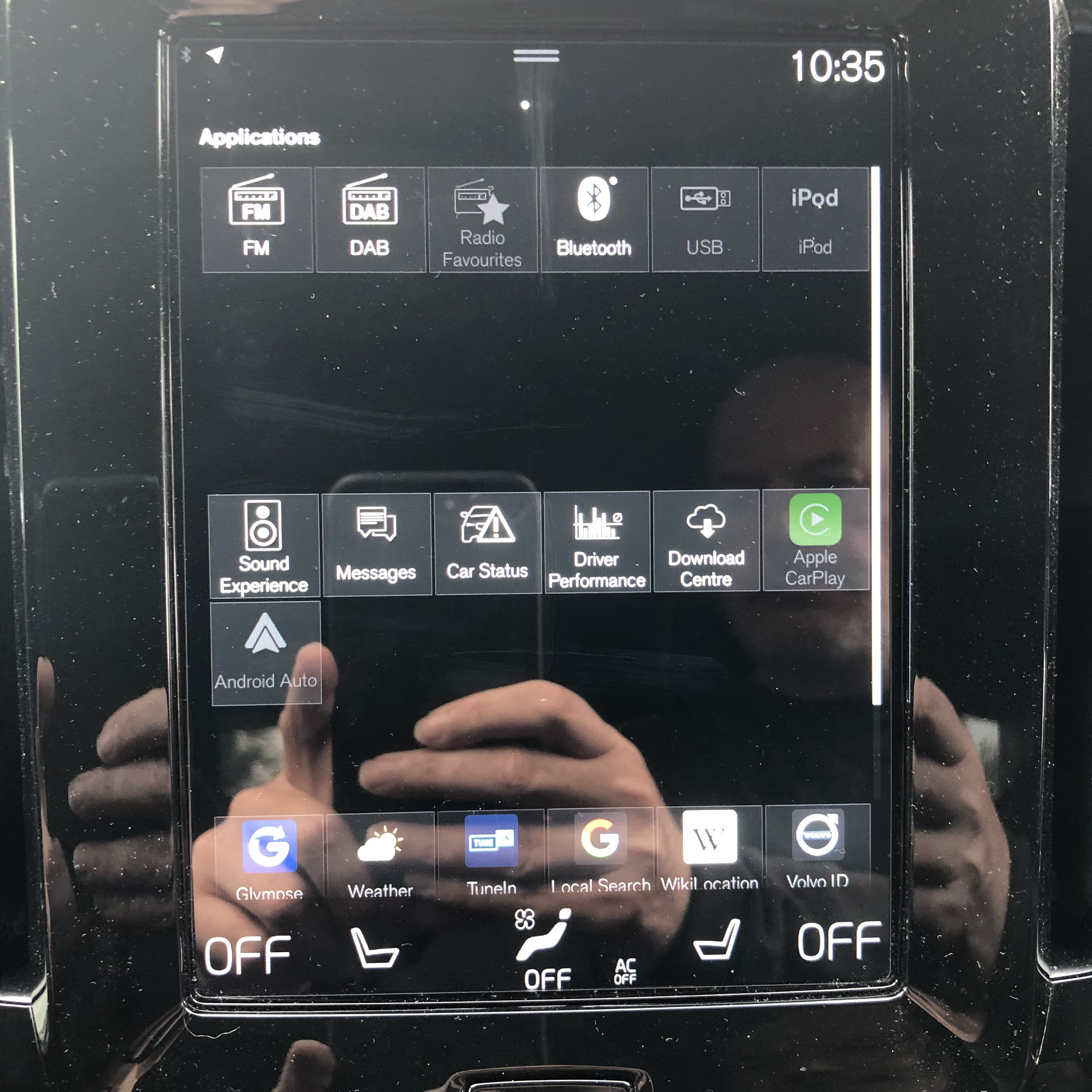

You can see in the online manual there’s an “Applications” view
Shows USB and iPod apps among others.
Edit - found this
Swipe from right to left across the centre display’s screen in order to access the app view from the home view. Apps that have been downloaded (third-party apps) and apps for embedded functions, such as FM radio, are found here.

I use an ipod touch in my xc40… initial connection is found on the left menu of the sensus panel along with radio funtions. Once you activate the ipod option it connects automatically from then on… Does your xc40 run sensus or andriod auto which volvo have switched to? Sensus is left to right to get the connection option

Thanks, Deeg. I had no idea this element of the menus was there, and the garage certainly made no mention of it. I guess they’re just used to people playing from their phones via bluetooth.

I just noticed that the manual says for RHD cars to swipe the other way!!!
Why not just say “swipe towards the driving position”…

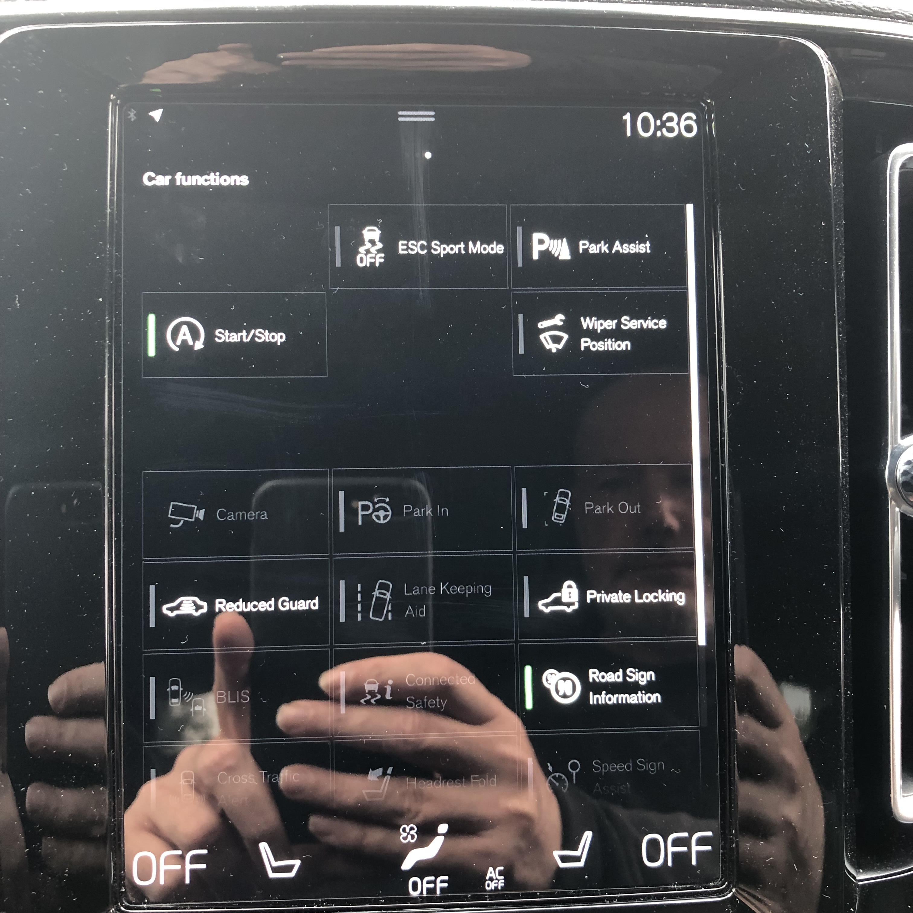

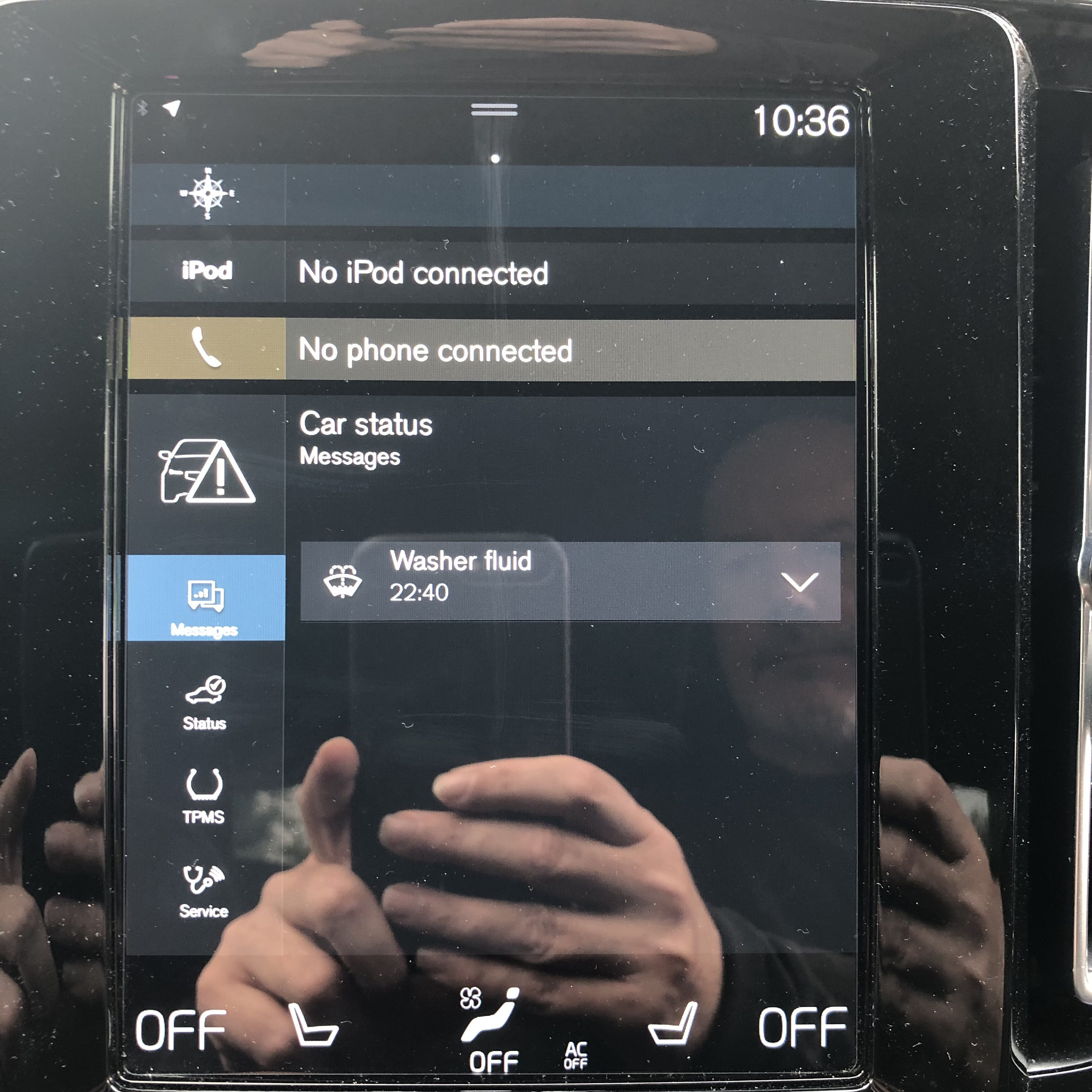

Not sure how to tell if its running sensus..
These are the three menu panels
If it is but as you have google maps rather than sensus navigation i image its running android.

Yes, mine must be Android as the screens look totally different. I don’t seem to be able to find a Media Player. I have downloaded and installed both Tidal and Radio Paradise. Tidal worked, at least to play one or two tracks (which must mean there’s some sort of SIM present). RP said it wasn’t working at present - I’ll have to check that one again later.
