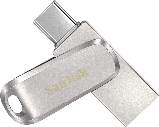

I bought one of these…
1TB with both USB A&C connections (car has C, computer needs A). It was almost £100 but it has plenty of capacity and is tiny in size.
SanDisk 1TB Ultra Dual Drive Luxe USB Type-C Flash Drive all-metal with reversible USB Type-C and USB Type-A connectors, for smartphones, tablets, Macs and computers.
