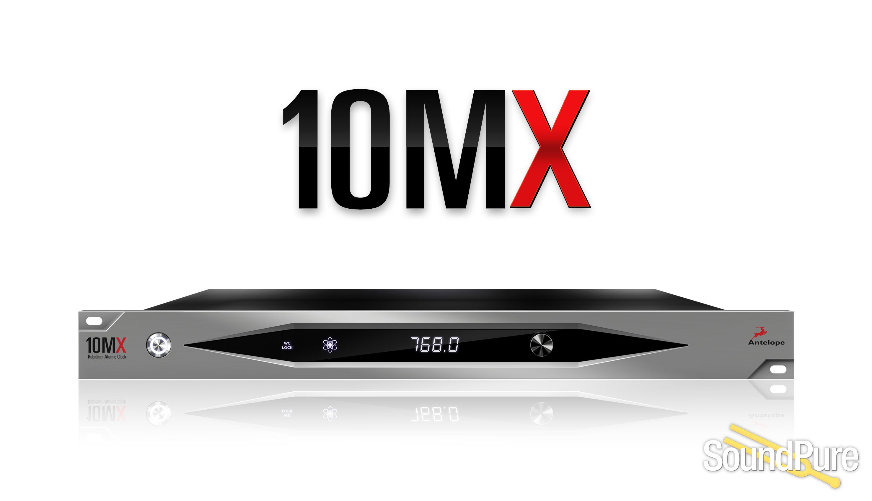

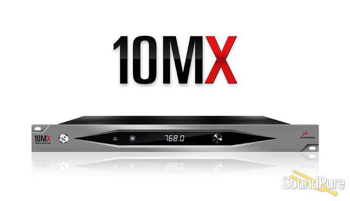

Antelope offer different clocks. One member uses the rubbicon with his Vivaldi ( @joeling).
You have the entry level Master clock for around 1,3 k.
  • Sample Rates Generated: 32, 44.1, 48, 88.2, 96, 176.4, 192, 352.8, 384, 705.6, 768kHz
  • Master Clock Outputs: 10x Word Clock Outputs up to 768kHz, 4x AES/EBU Outputs up to 192kHz, 2x S/PDIF Outputs up to 192kHz
  • Inputs: 2x Word Clock Inputs up to 768kHz, 1x Video Input accepting wide range of SD and HD video signals, 1x Atomic Input, 2x S/PDIF Inputs up to 192kHz, 1x AES/EBU Input up to 192kHz, 1x USB Input for control
  • Humidity: 30 – 80% RH non-condensing
  • Clocking System: 4th Generation Acoustically Focused Clocking, 64-bit DDS, Oven Controlled Crystal Oscillator
  • Clock Calibration: < +/-0.001 ppm
  • Clock Stability: <+/- 0.02 ppm, oven controlled at 64.5 C/148.1 F
  • Clock Aging: < 1 ppm per year
  • Atomic Clock Input: 1 x 10M Atomic Clock Input @ 75 Ohms 3Vpp on BNC
  • Sample Rates (KHz): 32, 44.1, 48, 88.2, 96, 176.4, 192, 352.8, 384, 768 (kHz)
wow just look at all those buttons and knobs you can play with :slight_smile:
You have a DCS now? Because your profile indicates Ndx.
As for the Antelope, curious to see all these buttons. Their more expensive 10MX has no buttons. Strange.
