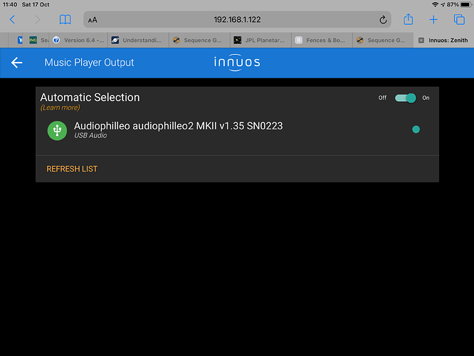

Have you checked that the Innuos is seeing the Audiophilleo. Note that the last digit of the serial number is dropped! It also gives the firmware version. The battery can need changing after 3 years if the play time gets too short.

Ah, thanks Phil.
The AP/PP was still not working, so I replaced the supplied BNC to BNC with one from my former Chord set up, and adjusted the tightness of the two screw fittings and it’s now ON. So it’s one of those connections that presumably was at fault.
Re: Innuos settings: That’s good, thank you. I’ve deactivated Roon, and I’m now running iPeng, and yes I’ve got sound!

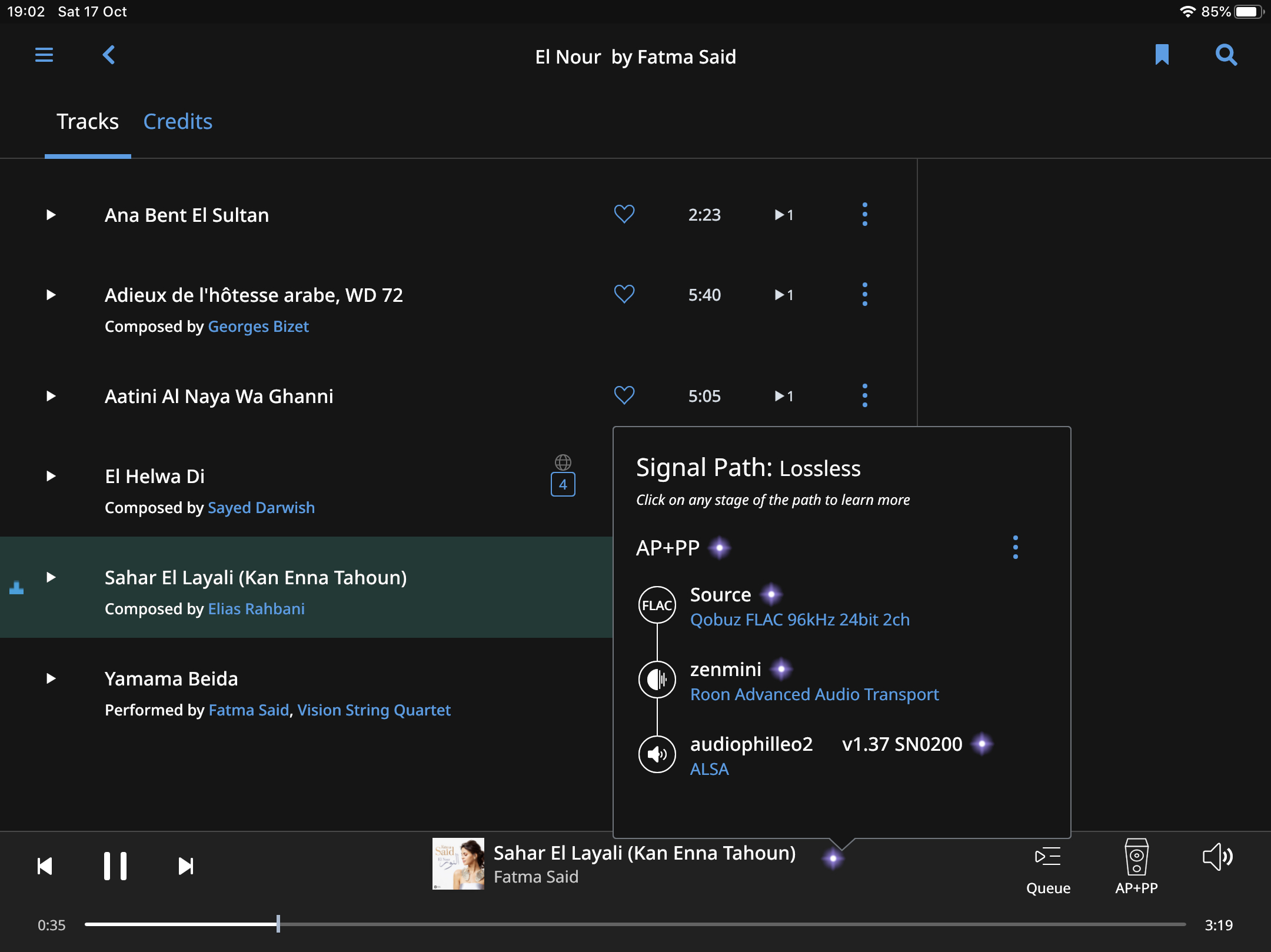

In option 2 what role is the AP playing exactly in the signal path? It actually sounds pretty fantastic.
If the Nova is using the BNC input then the AP is in action. It’s there to deal with whatever bitstream the Innuos sends it upto 24b at 192k.

This is my Roon signal path. What’s doing the D/A conversion? The Innuos or the Nova. I’m guessing the former, and the Nova is just in amp duties here, is that right?
The Nova. The Innuos Zen Mini has a basic DAC that outputs via RCA plugs.
