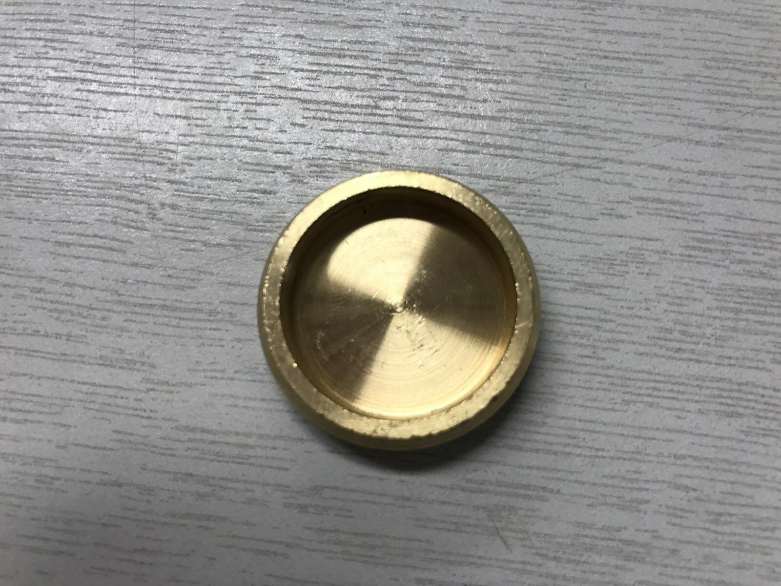

Assuming the inner diameter of the recess in the brass you have is 23mm I’ll use my own 5/8" bearing steel ball to make the indentation as that way I can use the jig I made to hold the ball in place during the impact (thinking about it the fact that I’m using a relatively rigid jig may be the difference as to why I don’t get double dents!).
The recess in the brass I have is 4.3mm deep and the ‘dent’ is about 0.3mm deep (by 3.5mm diameter), so with 5mm balls you’ll only have about 0.4mm clearance between the rim and the glass. You’ll need to ensure that the brass cups sit level, you won’t have much tolerance in the leveling.

I have “28MM COMPRESSION FITTING BRASS BLANKING DISCS” from Fleabay shop wwltd7779 based in WESTON SUPER MARE.
Before I ordered them the supplier told me that: “The base is 3 1/2 mm thick and the height of the rim is 3 1/2 mm”.
By deduction, that means that the 5mm balls should stick up 1.5mm above the rim - and indeed they appear to do so.
The balls and stop ends are in my office, and I will not be there until Wednesday morning, so cannot measure them until then to be sure.
I imagine that the rim is about 2.5mm thick, which again by deduction would mean that the inner diameter of the recess in the brass is about 23mm.
If that all checks out, would it be ok to post them to you with an SAE?
I would be extremely grateful, and will not worry if it doesn’t work out for some reason (e.g. they are hard for me to level), as the brass cups are not really expensive at all, so I can just try again if it doesn’t work.

Yes, the inner diameter of the recess in the brass cups is 23mm.
It’s hard to measure exactly, but the recess in the brass seems to be 4.0mm deep.
So if you make dents about 0.3mm deep, then the 5mm balls I’ve bought should stand up above the rim by about 0.7mm.
That should be fine after levelling.
(Anyway, if it doesn’t work I can either get some larger diameter silicon nitride balls or get more brass cups and try and different method of denting them).

Thanks for all the details you’ve posted. I’m taking the plunge, my current setup has the hifi on a large wooden entertainment cabinet so I think it will benefit quite a bit from some isolation. I’m in Melbourne, and found a local supplier for 40 x grade 10 silicon nitride balls and local glazer for 10 mm toughened glass willing to do a deal. However the plumbing supplies come with $200 delivery fee, so I jumped onto a site and ordered a bunch of 3 mm X 16mm hexagons used as jewellery blanks, they don’t have sides so I’ll need to be careful during placement, hopefully that will be ok. I’ll sand the bottom of the bronze after I dent the tops. Looking forward to it!
I think I will have plenty of spares if anyone else is in Melbourne, please reach out
The problem there is that if the ball gets pushed out of the recess, there’s nothing to then stop it from rolling all the way off the bronze disk (and taking the glass and the audio component with it)!
You may like to get some pipe or pipe fittings (plastic or copper will do) that fits around the hexagons and cut short sections with a length of about 2.5mm + the diameter of the nitride balls. This will keep your audio component much safer.
Yes I have more disks than I need so I might drill a big hole in the middle of some of the spares and create a sandwich to retain the ball in the middle of the dent - It might look quite good !
That’d work! I like that idea.
