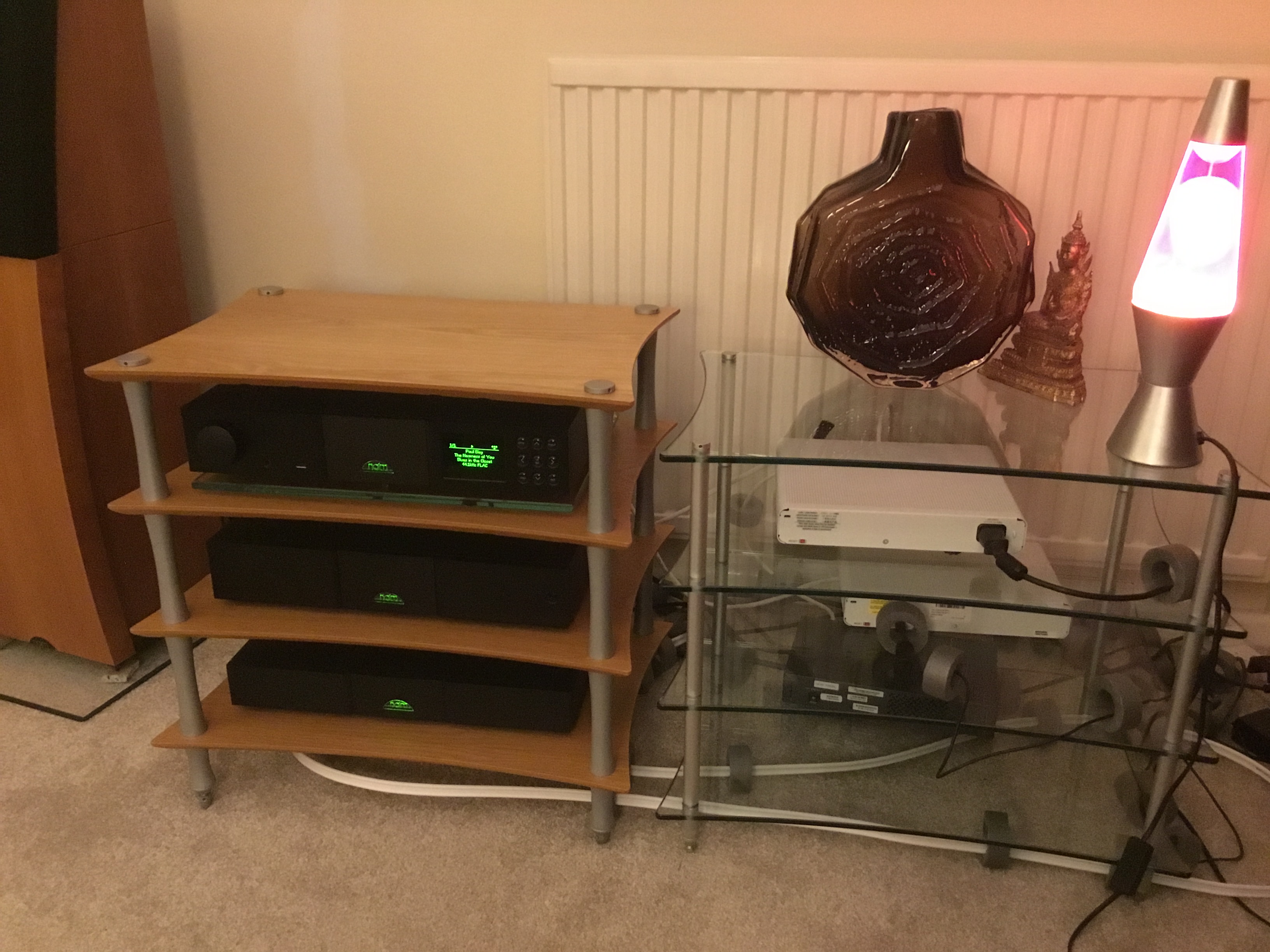

In the pic in the previous post, you can see that I have 2 Quadraspire Q4 EVO racks, both bought SH for £200 in total.
One with glass shelves and thin columns, the other with oak shelves and thick columns.
The 3 Naim components will end up being suspended on 10mm toughened glass shelves on the 3 ball system discussed on this thread.

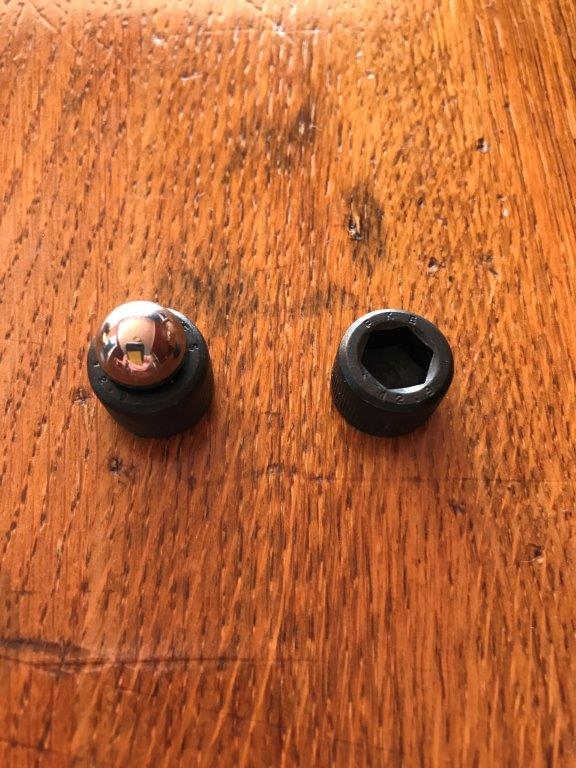

All dents done, 1 slight double strike, 1 slightly light strike, all the rest perfect and consistent, and even these two would still be fine to use. (They are marked up in red, water based ink.)
Thanks for waiting and tolerating my delays; as a thank you I’m going to include a set of 3d printed ball retainer cages for you (these are now being printed).

All bits produced and internal packing arranged, tomorrow I hope to pack it into the outer envelope for post and get them off to you.
Incidentally leaving the bottoms of them rough ground is intentional: it helps to stop the brass cups sliding around too much and makes them easier to position.

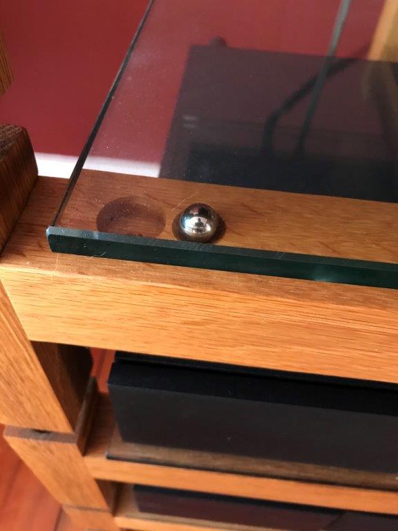

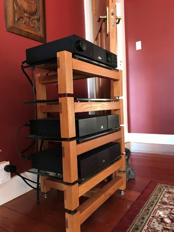

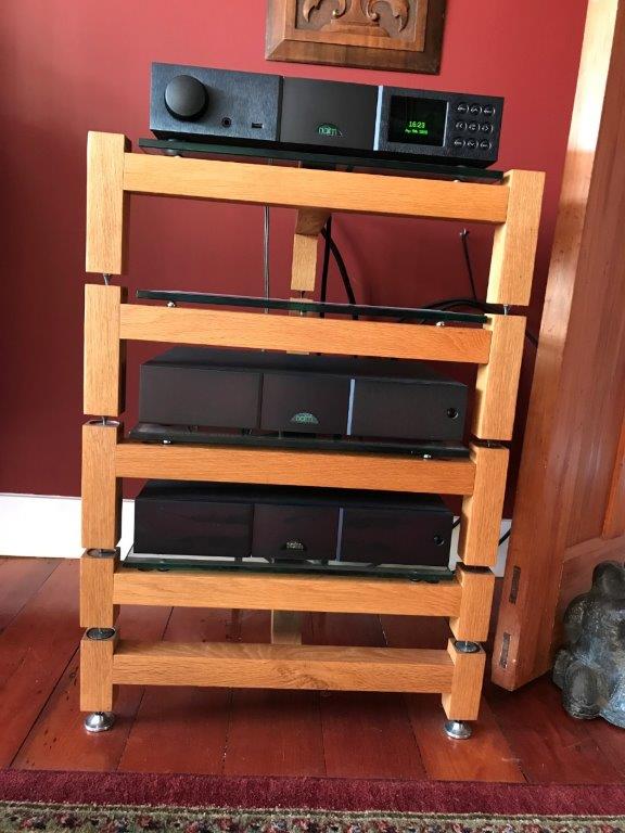

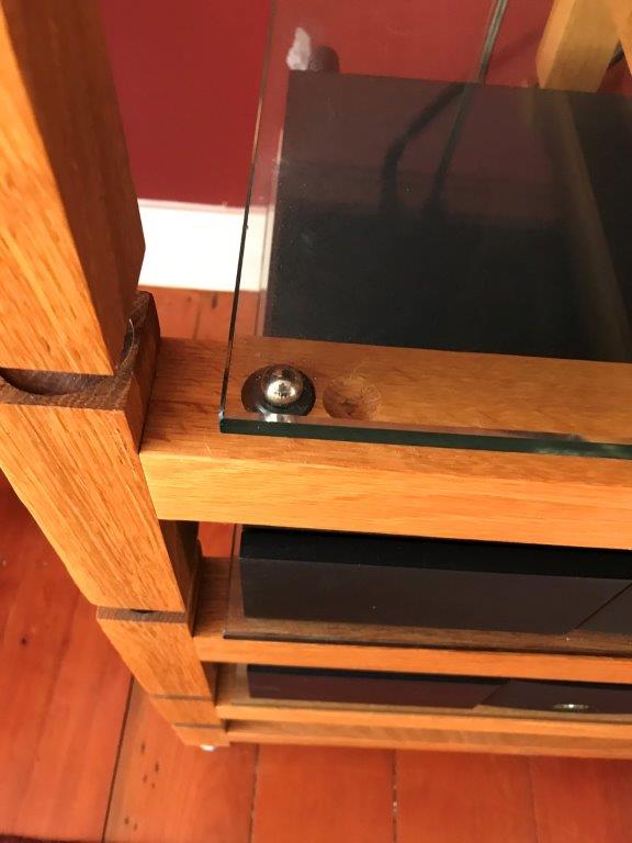

Been reading this topic with interest having done a fair bit of experimenting myself! Photos follow of a stand I made from American white oak a few years back. It was loosely modelled on stands made by Steve at HiFiFoFum in Toronto who I met and had a great chat with over Xmas.
Glass is to Naim Fraim specs and dimensions. Initially I tried using Allen Keyed bolts with the threaded portion sawn off holding 10mm steel ball bearings. It worked well but then I landed on cutting a spherical dish into the stand itself and placing the ball bearing in that - thus the glass is free to move laterally but constrained vertically within the cup. This substantially improved the sound and I’m very happy with the results. The flexible mount was a little disconcerting during the Kaikoura earthquake a few years back when all the Naim boxes were as if mounted on jelly - interestingly the Naim boxes were in fact “still” and it was the stand that was moving…
Spikes and feet are from Track Audio.
