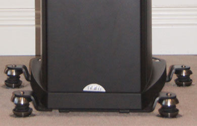

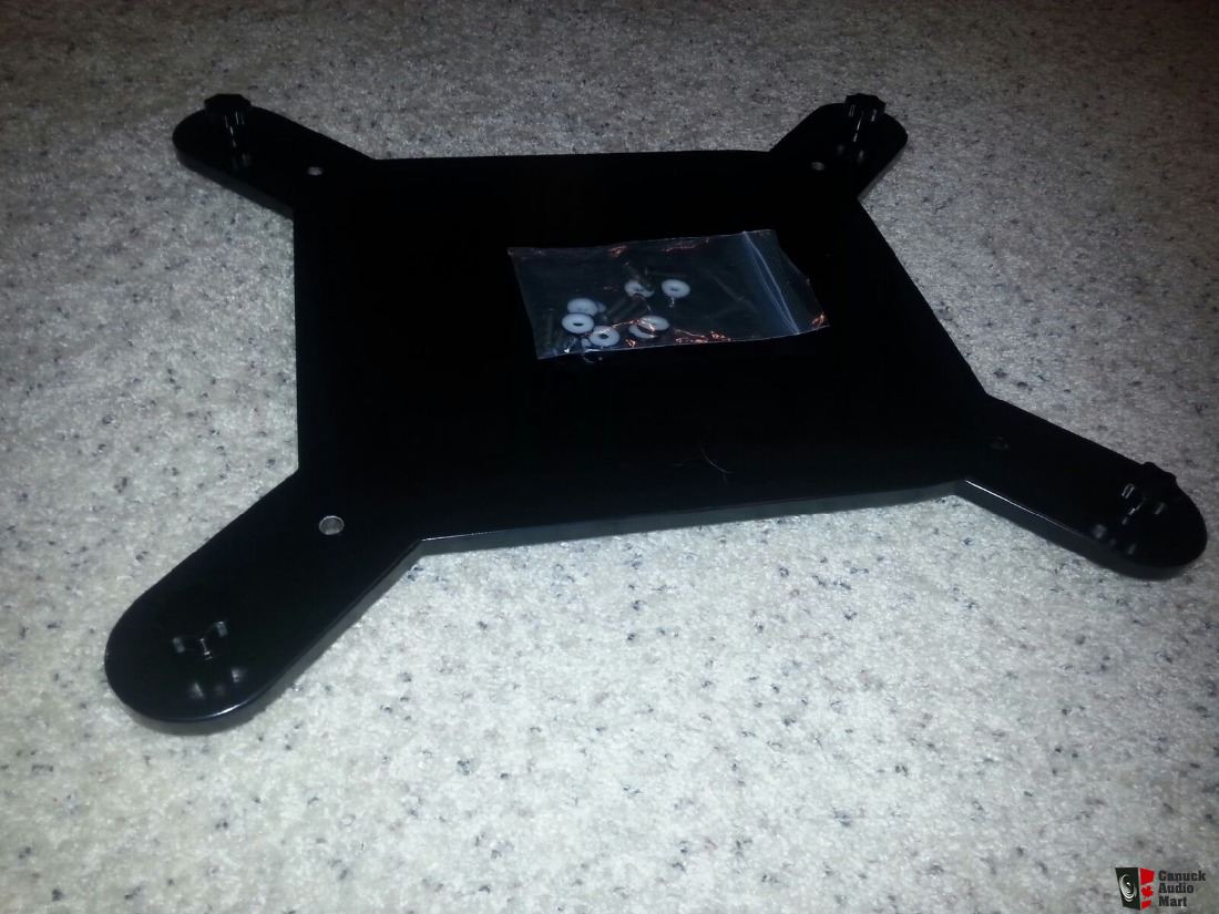

Here the kharma speakers stand.
Kharma
Townsend podiums
Are the Kharma sprung or damped in any way?
if they are then it might interact badly with the leaf spring mech in the speakers
They are damped. Can’t answer how it will interact, but a 1cm slab aluminum should better isolate from the floor for sure. And it doesn’t sound bright.

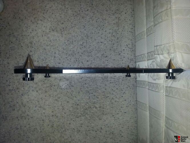

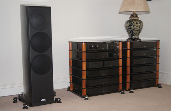

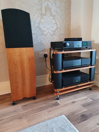

@HiFiman SL2 on spikes and some isolation devices.
Picture shows Linn Skeets under the Fraim and old Atacama shoes under the SL2s now replaced with Fraim chips.

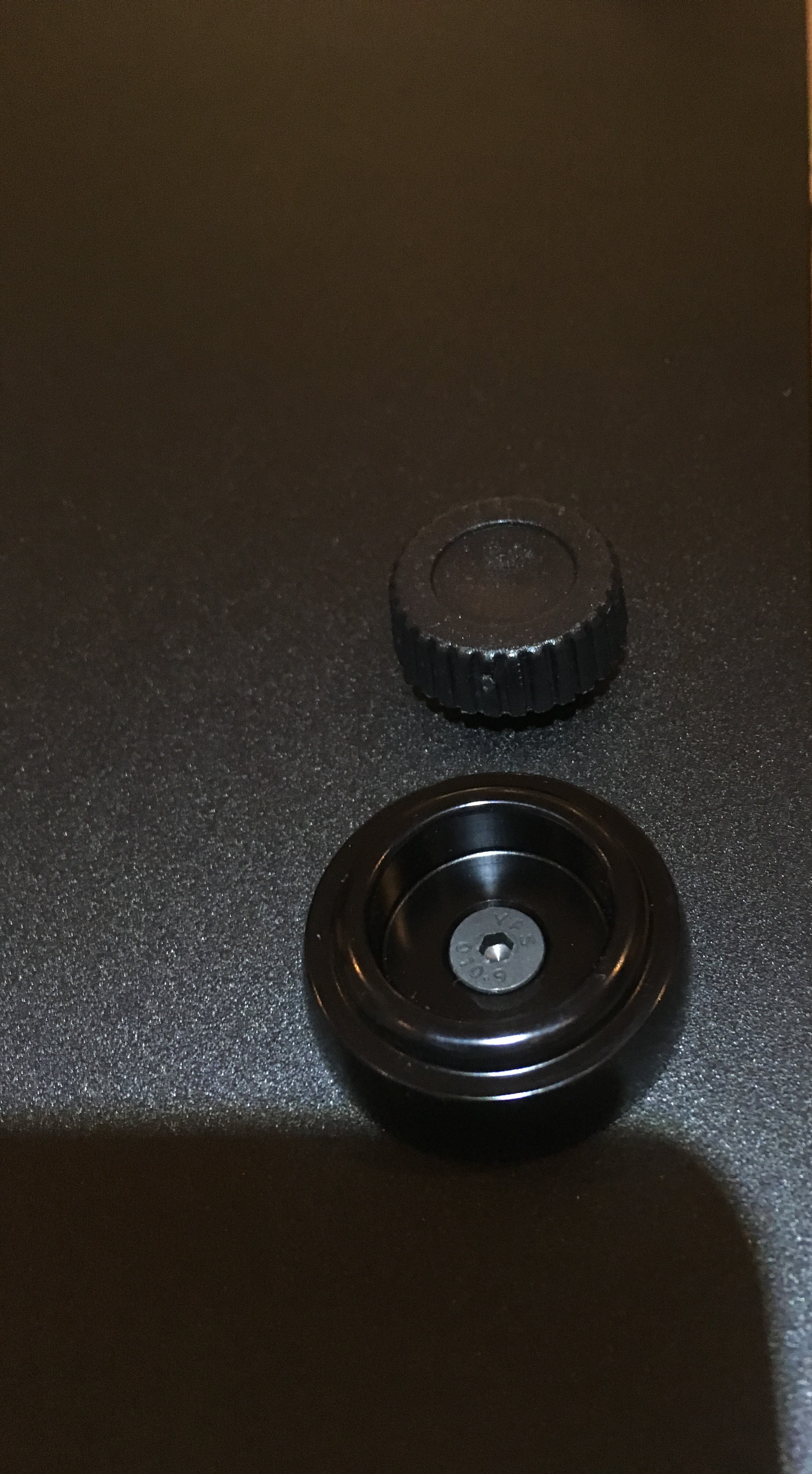

Hi @Xanthe,

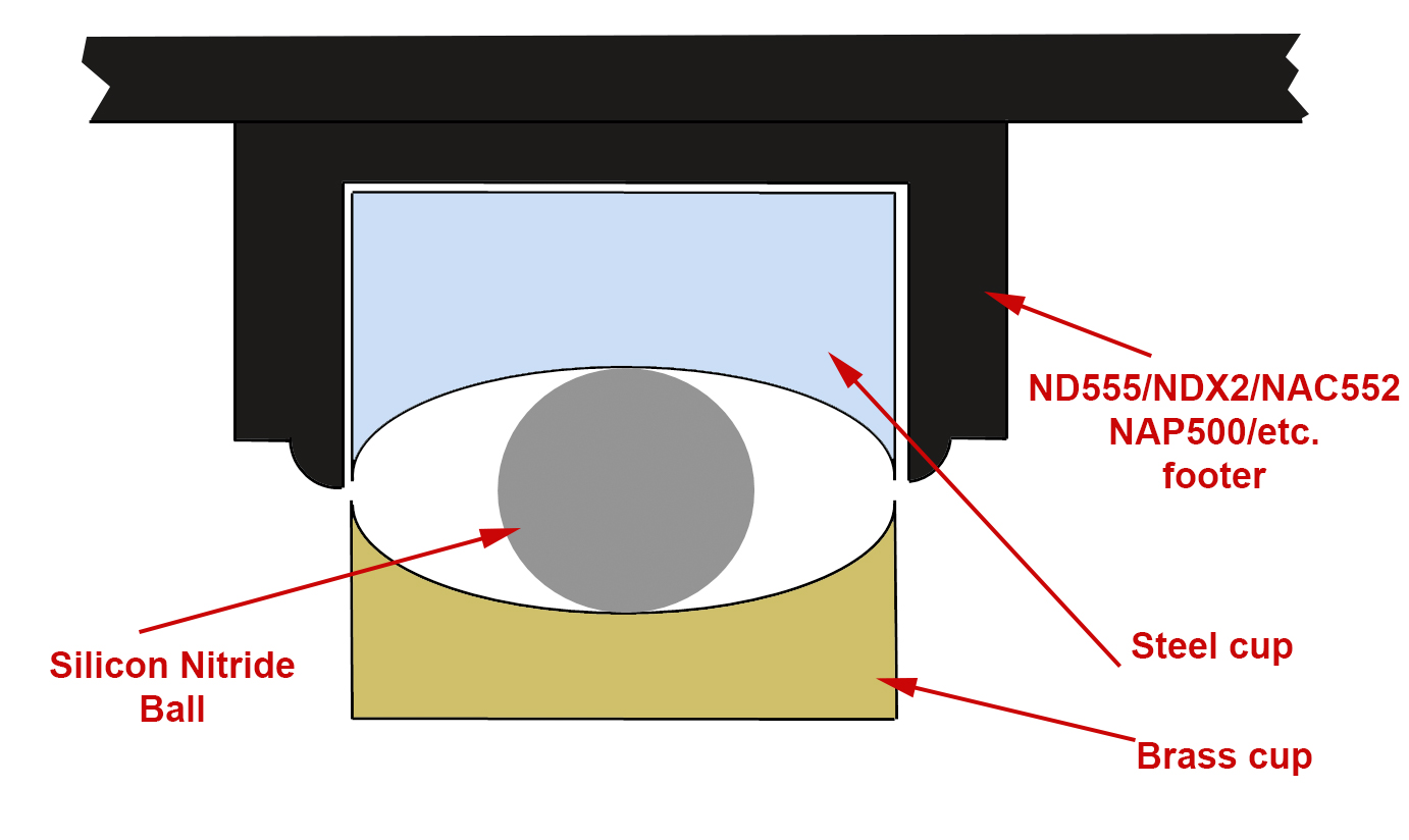

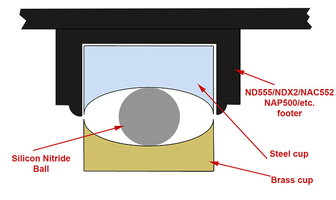

I’ve been thinking of a discreet and simple solution using the ND555/NDX2/etc footers.
The idea is to insert the isolation system into those footers, like so:
What do you think about that idea?
A couple of options that would also be worth trying:
1 Using brass above and below the nitride ball.
2 Through harden (or case harden) the steel.
In the case of the steel, getting the bearing surface polished smooth enough to completely eliminate ‘micro rattle’ issues is going to be a, well, shall we say, “interesting challenge” (but by no means impossible!)

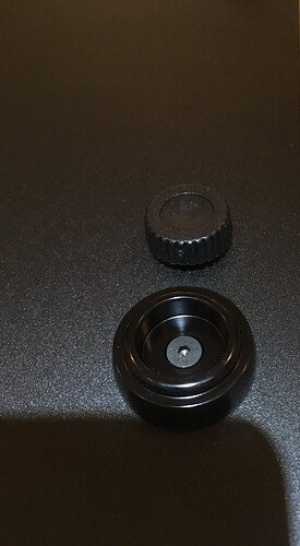

But would you be removing the rubber Insert feet from the naim foot or is it purely adding?
Sorry not ever looked at the feet
