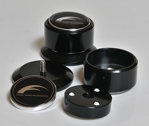

Franc audio ceramic disc.
You have a review on 6 moons audio. com
If you find the special saw to cut ceramic, I will do that :smiling_face_with_sunglasses:. Good luck :zany_face:
With laser?
Thank you, they look as though they’re possibly alumina.
Can it be delrin?
No need for a laser, all you need is a small diamond abrasion saw - you can easily get one that fits a ‘Dremel’ style rotary tool.
It must cost a lot, not?
No, as Delrin (a trade name for polyacetal) is a polymer not a ceramic.
I think they’re about £10 / €11 (I think they’re only about 25mm diameter by about 0.7mm thick).
