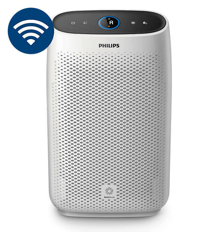

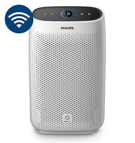

I always fire up the air purifier before cleaning a batch of records. The hepa filter works wonders at removing dust.
I can recommend the Philips 1000i, the wifi connection is even more stable than the Muso Qb Mk1 :innocent:

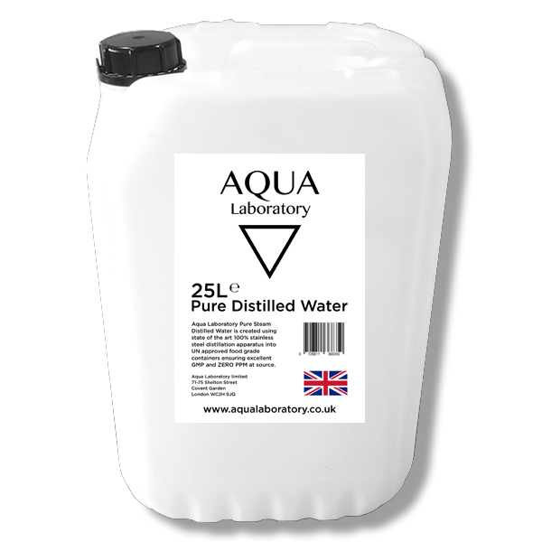

I use this distilled water in my RCM and I am happy with the results I get:
It has never occurred to me to leave it 2 minutes, what does that do?
In terms of wetness, it should be enough to create a continuous film over the whole record when brushed, but if it runs over the edge that’s getting a bit too much. No need to press too hard.
