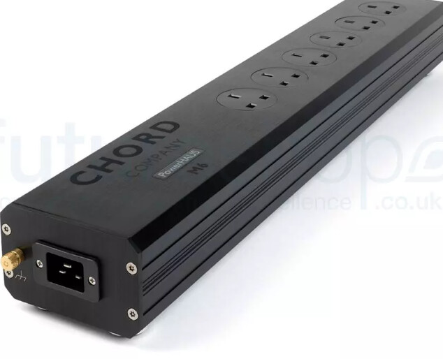

I was considering doing the same as my Chord powerhaus M6 power block has the matching C20 plug built in.

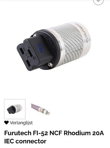

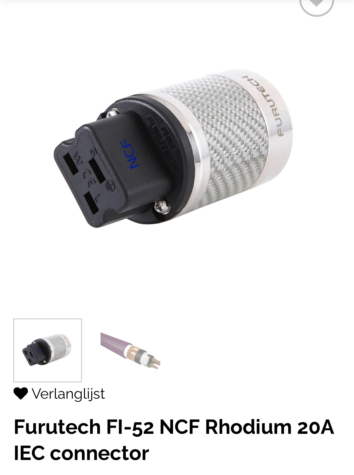

Yes, it’s a bit confusing. I use a C19/C20 connection (Furutech rhodium btw). The female plug is C19 while the male inlet on the power block is C20. Most are rated 20A.
This is because circuits in Japan are nominal 20A so they produce their IEC male plugs to conform to that.
