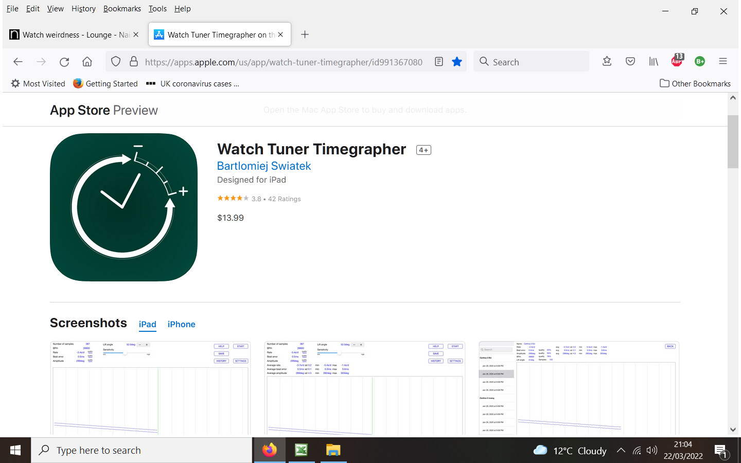

Maybe you could invest in this. Or similar.
I’d have spotted that straight away. :grinning:
