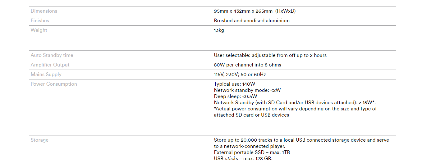

Hi @GadgetMan ,
Its quoted in the technical spec of all products on the website. For example here is the Uniti Star one:
Regarding considering it as a feature, we’ll look into it. Stuff like this needs to be balanced up on more key features that keeps the products competitive in the market place (and keeping code stability of what we have already) vs implementing power features for a small small subset of users (very few users use USB drives as their primary playback source and want this feature).

Many thanks Steve, I raised this based on an NDX2, so haven’t checked the other products. Looks like you may have missed one
