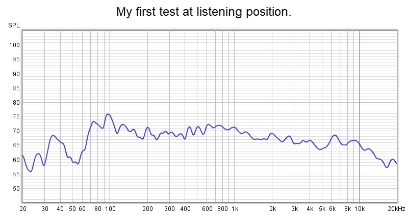

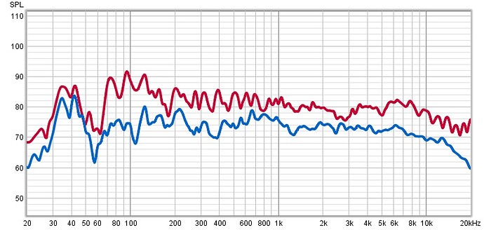

Mic received and i did the first testing, thanks @Simon-in-Suffolk and @Innocent_Bystander for your assistance.
Connected UMIK1 through USB to my laptop, and downloaded from the internet Pinknoise, copies to USB and plugged into my NDX.
Very informative, shows i have a big drop between 50 and 60 Hz, i guess this is due to room geometry, will get this over to GIK and seek their advice on some room treatment to take care of this.
Will be doing some reading on this, there is a sea of information.
Cheers guys.
Hi, the drop or equally often peak (boom) around this range is as you say down to room geometry and reflections…
You may find moving the speakers or listening position radically changes this bass response… it won’t necessarily sound bass light, which in my experience is around 100Hz to 400Hz, but you may feel it’s light on the deep bass or what some people I think calle ā€˜slam’ of the sound.
I would ignore anything below 30Hz is there is little or no info there, and most commercial music has this filtered off.
The area that appears critical is the 500 to 3000 part, where there is much information. The higher end of this can be prone to reflections causing a comb like response of constructive and destructive interference. This can be the difference between a system sounding natural or artificial… room furnishings and speaker placement can affect to. Yours appears well behaved, I suspect your system might give you a slightly warm sound?

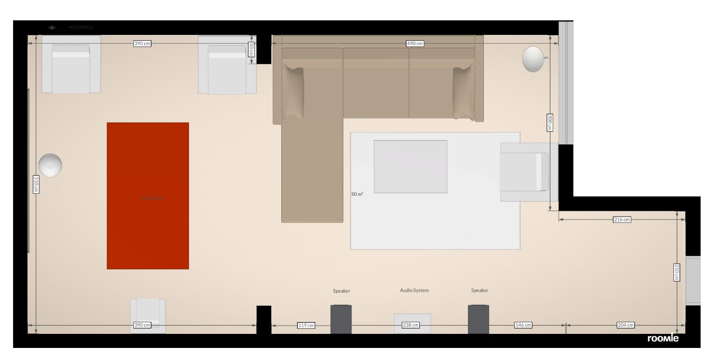

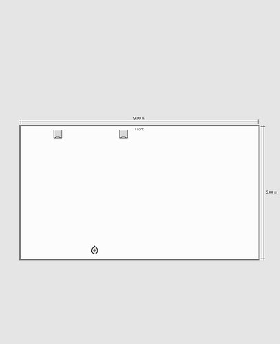

My room is a weird setup since it is a living room and not a dedicated listening room.

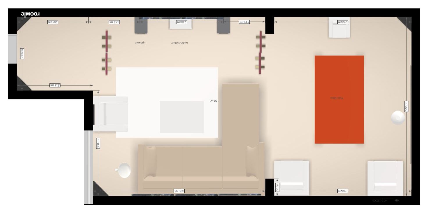

As you can see in this picture, the music system is in the left part of the room where there are sofas, the right side of the room is occupied with a pool table. This is an very setup since i have a left sidewall, but the right side wall is far away from the speaker and on the other side of the room. So i guess there must be an issue of timing since the reflections are not symmetrical.
My plan is to order movable sound absorption panels that can stand on the floor and hence somehow create a sort of right side wall to the speaks, this i guess will enhance the current warmth of the sound and allow it to open up. Bit of a hassle though since i have to move them back and forth when doing serious listening. If i do this, i can do i on both sides, left and right of the speakers.

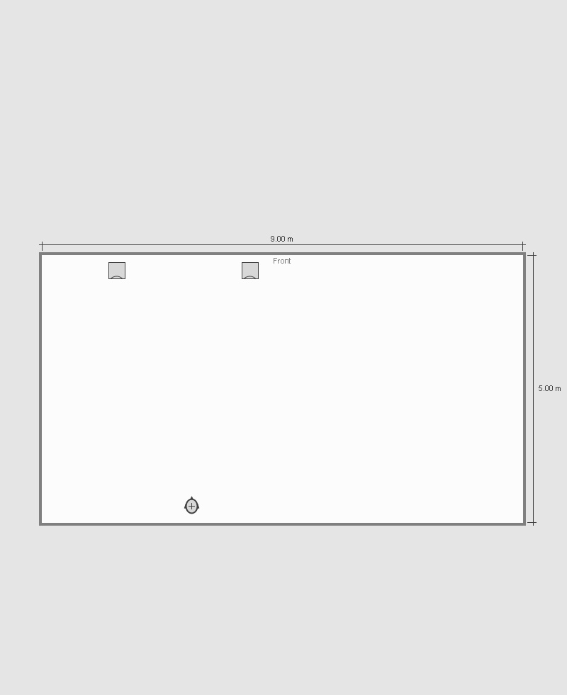

View from REW Room sim:
Current setup:
Planned setup with two floor standing side panels:
I guess this will enhance my PRaT.

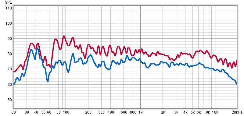

I have created the WAV file, and the results are very different.
Red graph is the new curve
Blue graph is the previous one.
Cheers Simon, will do further testing and more reading on REW and interpreting the data.
