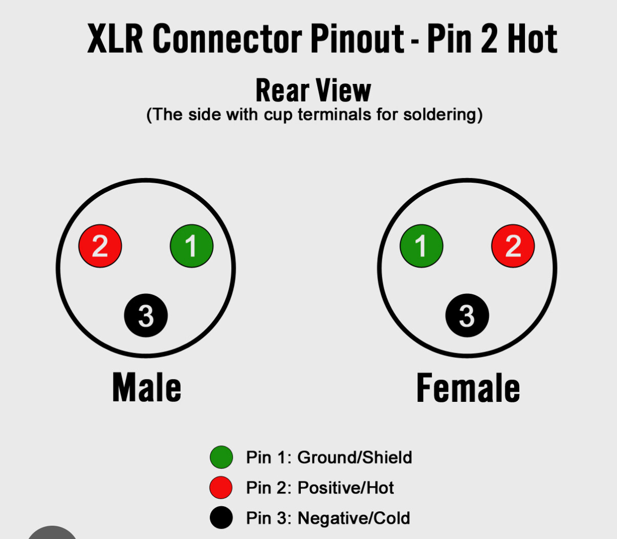

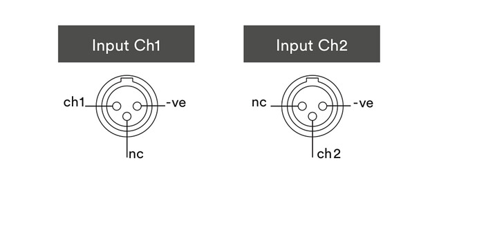

No. The 500 is not balanced, so it needs to be wired correctly. The 500 should have the pin connections on a label on the back.

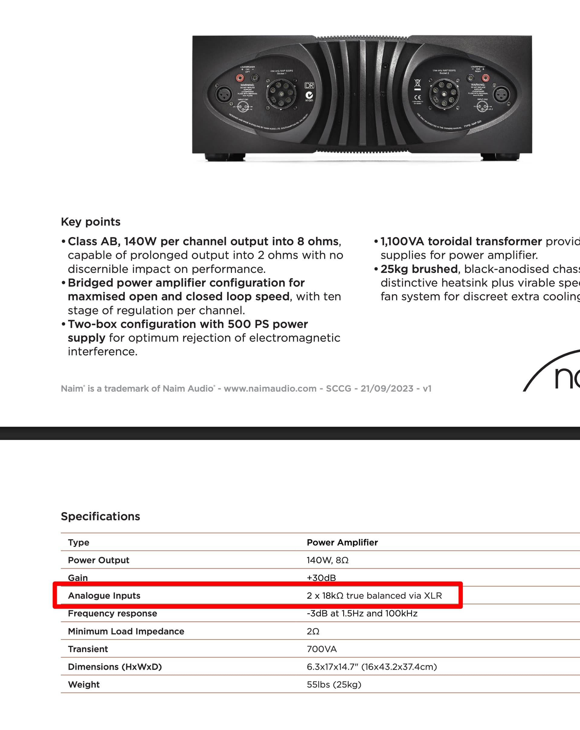

But why does the spec says “true balanced via XLR”?

I don’t know, and I may be wrong.
The 500 is connected like this, with just two wires:
Balanced is like this, with three wires:

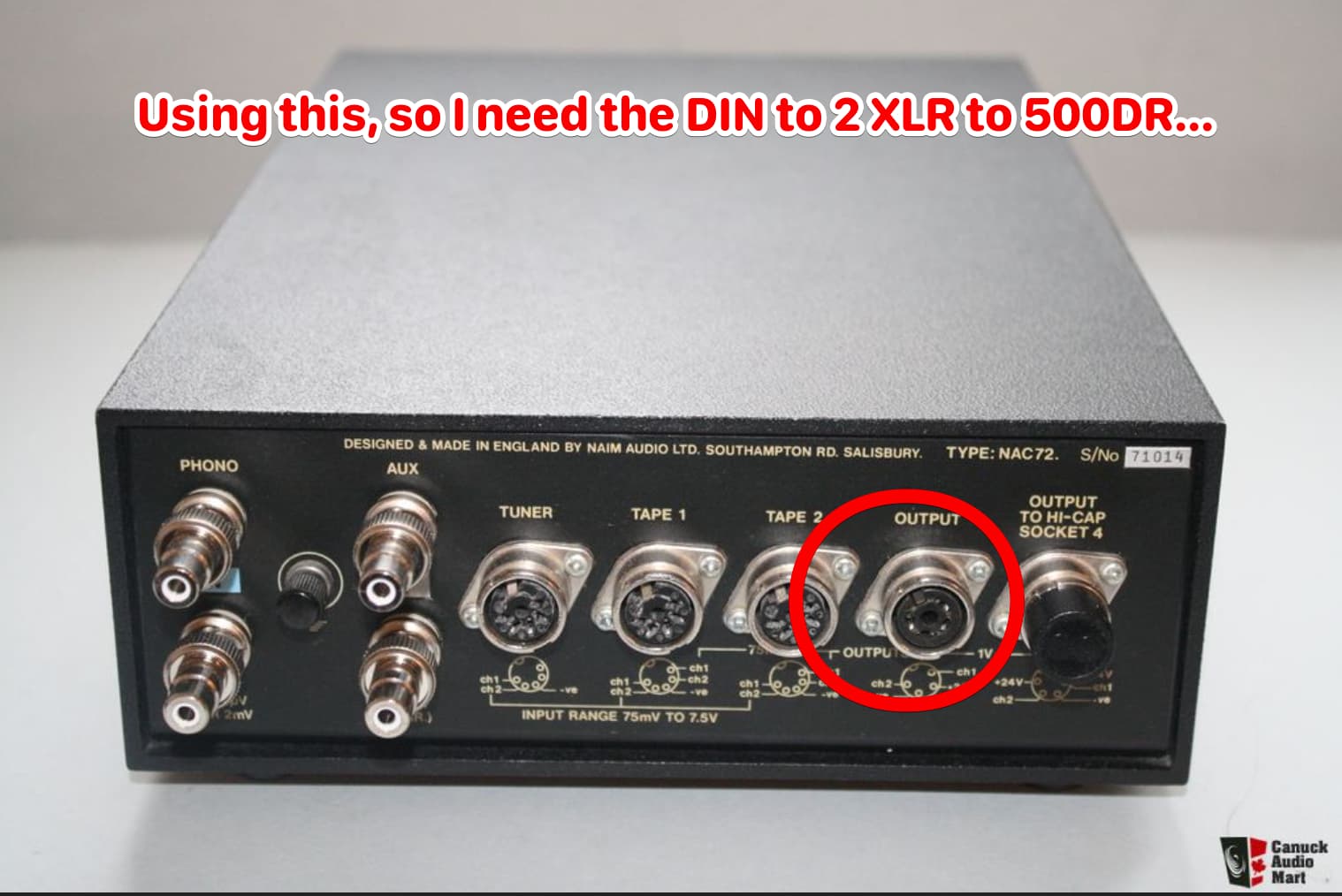

I used my old Olive 72 with my 500 when I sent my 552 for servicing. It worked fine.

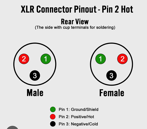

Is this correct? Using a single-DIN to 2 XLR to the 500DR.
