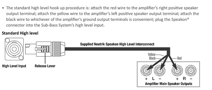

BackToNaim, I used the standard connection recommended by REL as shown in the attached. My Naim dealer soldered a ring on the end of each of the three wires, which slipped conveniently over the posts on the Naim speaker wire connectors at the amp end. I crimped them a bit to ensure contact, then plugged the (R) and (L) connectors to the amp. The plug on the other end of the REL wire goes into the REL sub. By using this method, the sub is picking up (and playing) signal from both (R) and (L) channels.
